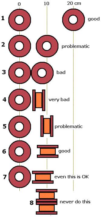

I don't have any pictures of them on one board, but it is pretty easy. The layout can vary a little so long as the inductors aren't turned the same way.

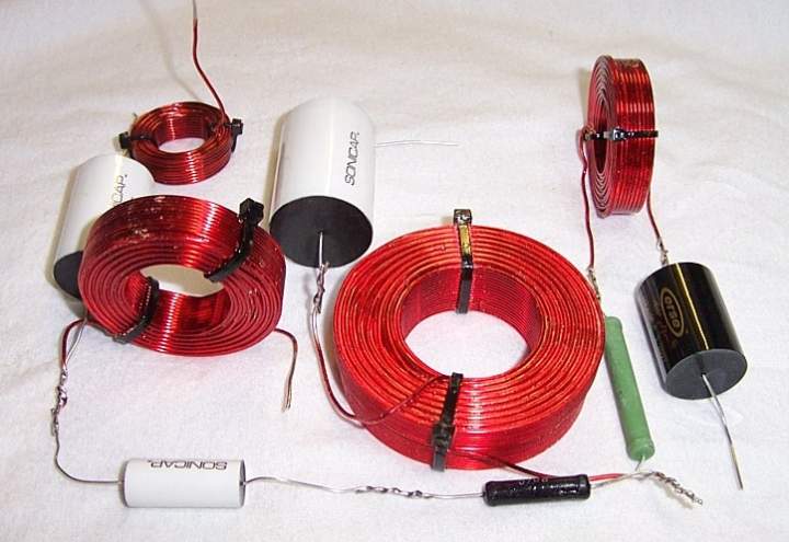

I truly don't remember who posted this way back, but it is easy to look at and understand what Danny is talking about with Coils.  The second image is a V2 cross i believe, maybe that will help you on your path to a nice layout.
JP
Hope this helps, I also prefer one board for all the N3/s/or tis
grimace
Re: N3 TL build question
« Reply #7 on: 11 Aug 2011, 12:12 am »
Thanks JP. As I said above, this is a first time for me (complete newbie). Is the pictured layout of the crossover that you posted for the N3?
jparkhur
« Reply #8 on: 11 Aug 2011, 01:38 am »
No, see description. V2 i think
