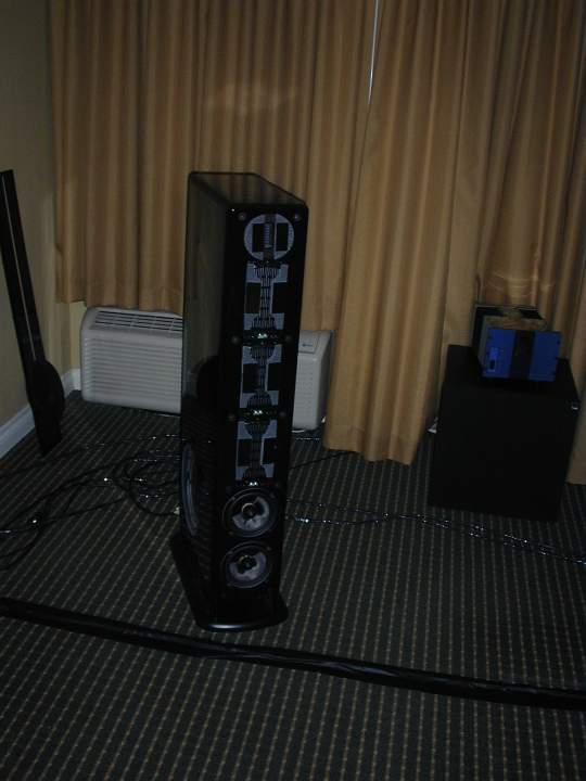

Would anyone out there mind showing pics of their speakers with the new CDWG's installed?  I would be especially interested to see a shot of the model I own (RM30) with the new guides.
PS - I love the look of the old CDWG and dislike removing them... I wish there was a way for both to coexist and still produce top notch sound.
John Casler
Re: New CDWG's NOW available
« Reply #82 on: 12 Sep 2011, 07:18 pm »
We had them on the RM30 Series II in Newport Beach in June.
