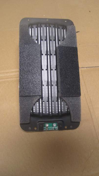

Time to explain how the CDWG works, and why it works well in this application.
The principal of the diffraction slot is well known and is the basis for almost all constant directivity devices for 30 years now.  With planars, unfortunately, simply making them narrower is no solution, as their sensitivity would be very low if made wide enough (2/3") for CD dispersion up to 20kHz.
BG in its PDR versions of the Neo 8 panel simply masks off part of the diaphragm to make a narrower slot.  This causes a lot of energy to be reflected back into the driver, and the resulting IM distortion is quite objectionable.
My solution was a damped slot, with substantial absorbtive as well as reflective components.  This is what made our CDWG patentable over the prior art.  Many opponents objected to the granting of the patent, but after 5 years, we prevailed.
In the second generation CDWG, the device is reduced to its simplest components and attached directly to the driver frame.  The opening here is about 1", corresponding to a 12 kHz CD characteristic.  This is fine for our panel, which rolls off mechanically at that frequency.  Only half the diaphragm is forced into constant directivity, and then there is a gradual transitiion to narrow dispersion.  In this fashion, there is little or no audible treble rolloff for the on-axis listener, and insertion loss is very low.  The panel now mimics the cardioid dispersion pattern of many musical instruments and voice.  The difference in disprsion patterns is what makes speakers sound so different from live sound as far as directivity is concerned.
A similar CDWG with a narrower opening, designed for planar tweeters, is also available, as are antiffraction masks for tweeters that are already narrow enough for CD behavior to 20 kHz.
It takes a pair of CDWG masks to treat a single panel or tweeter, and these are $20pr.  You would need two pair to treat the panels in a pair of single panel speakers like the 626, or the single tweeter in any FST speaker.

I'm actually impressed, these attachments are... Good looking. I don't know why, but in my mind I imagined giant foam half cylinders glued to the front of the speakers face.  :duh: Don't take any of this the wrong way.  :lol:

Heat the foam with a hairdryer or heat gun to loosen it.
Foam alone makes an antidiffraction mask.  Foam with the plastic overlay makes a waveguide.
