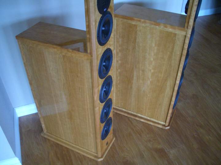

ebag4
Re: Hardwood front baffles?
« Reply #7 on: 31 Mar 2011, 05:11 pm »
Just be sure and add a large radius to the back side of the woofer hole as the baffle gets thicker.
Although I didn't use a hardwood baffle on these (see pic) I actually made the woofer holes in the main box larger than the required cutout and rounded them off in the back to eliminate the possibility of additional back pressure to the woofer.
