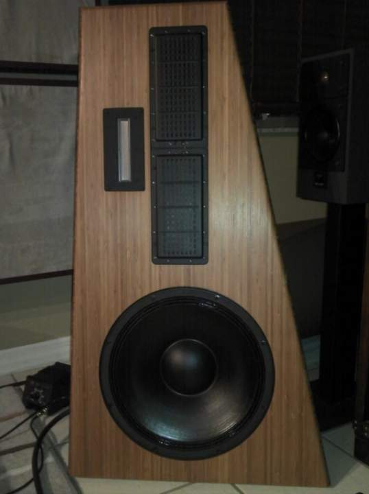

there are other options between neo3 and RAAL that i personally like even better then the RAAL dipole because they are less expensive , high efficient, and with lower extension.
there are a few AMT drivers that can be run without back , fully dipole.
Mundorf comes to mind . i use a beyma TPL150.
they can be crossed over lower then the RAAL , most of them around 1000 or 1500hz.

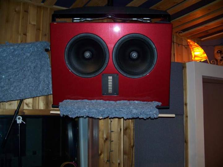

I've got direct experience with both the TPL-150(used in standard closed back mode) and the Raal 140-15.  I have to say that IMHO, the Raal wins for an airy effortless, almost floating sound.  Not really sure how to describe it.  The TPL is great where high SPL is needed and a more robust driver for applications like large studio monitors or even PA systems.  We never tried the TPL with the back removed for obvious reasons, but others report even better performance.
We used the TPLs for our studio monitors after trying the Fountek Neopro5 and not liking it and also a Beyma380 compression driver on a waveguide.  I tend to like my tweeters crossed higher than some.  Not sure if I'm extra picky or what, but we have the TPL set at a 1.8KHz 24/oct slope and I don't like it any lower than that.  Other people using the version with the horn, are running down closer to 1KHz.
For my home set-up, I am currently crossing the Raal at around 3KHz.
