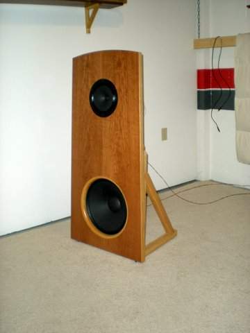

I just thought I'd drop a line to contribute my OB project. I've owned these about 6 months and after trialing several baffle dimensions, filters and amping, I've settled on this design.
I'm bi-amping the units using the two RCA outs on my preamp. The Visaton runs full range with no filter, the Eminence runs with a 9.5mH coil. I use a 2A3 SET amp for the Visaton and a SS 150 watt amp for the Eminence. I do use a bit of EQ in my J.River playback software. I cut the bass about 3dB under 170Hz and boost the treble 4dB over 6kHz. I find the integration very smooth.
My previous speakers were a pair of Bob Brines MLTL using a Lowther DX3. I loved them for ~3 years, but just needed more foundation to my music below the ~500Hz point to support the low end in my music, these do it nicely. Thanks for looking.

Congratulation!
Nice front finish. Did you insert a separate ring around the woofer front? Looks very carefully made and is a good contrast.

Thanks for the comments.
The baffle is 1.5" thick Baltic birch with cherry veneer on the front. The Eminence drivers are rear mounted. I used a 3/4" radius bit to round over the front of the driver's opening. You're seeing the color difference between the cherry and birch ply.
Jim

Your speakers are absolutely beautiful! Just curious, what kind of music do you listen to with them? I am a novice as far as speaker building goes. I really like the look of the open baffle panels and think a set of them would look really cool in my family room. I'm sure my wife won't agree with me, but I'll cross that bridge if and when I get there. Anyway, the majority of the music I listen to is pop, classic rock. Would a set of these work in that setting? Thanks for any and all advise. Tom

Might inserting a second woofer be an option in case there is space enough?
That´s what I did (2x Alpha 15A and Ciare CH250):
Hope I did not highjack your thread with this pic.
Till

Rest easy, no hijacking considered. Very nice speakers you have there.
Regarding bass output, perhaps I have mislead with previous comments. My bass output is fine, in fact I cut my lower octaves via the EQ in J.River so it doesn't overpower. However, the bass does not move the air in ways that a powered sub would. The movement of the Alpha diaphragm (as you know) is quite small vs. a sub, so I don't have the chest compression impact that is required (imho) for classic rock.
