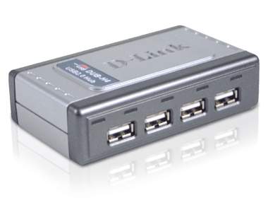

Hi Folks,
We have tested the powered D-LINK DUB-H4 4-Port USB 2.0 Hub with the BDP-1 and it works great.
So if you want to have more USB Drives connected (especially the 2.5 inch very large 1.5 and 2TB units that use a lot of power) then this powered USB Hub is a good solution for adding more drives to the BDP-1.

Would it be possible to use a non-powered USB hub with multiple USB flash drives? Could this work with the non-powered USB input(s)?

Hi konut,
The idea with the powered Hub is it prevents multiple USB drives from being underpowered. Multiple 2.5 inch large capacity TB USB-powered drives could tax the USB ports in the BDP-1 and limit current to the drive.
Without testing I can not be absolutely sure but as long as the attached USB thumb-drives do not exceed the power available from the BDP-1 USB outlets you should be OK using a non-powered USB Hub.

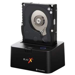

Mike at Bryston uses this with his BDP-1.  If you want to use very large drives (1TB and larger) with your BDP-1 this may be just the ticket. :thumb:
http://www.tigerdirect.ca/applications/SearchTools/item-details.asp?EdpNo=3516746&CatId=2785

I use one to recover files from lacie external drives when the power supply dies on them.  I guess you could use it like a big thing drive :)

Picked up the Thermaltake BLACX Doc as mentioned in the link above.
Purchased a 1TB Deskstar Hitachi 3.5 inch SATA drive and a WD Scorpio Blue 500GB 2.5 inch SATA drive. Formatted them both using the FAT32 tool mentioned in the other thread and it works and sounds great on the BDP-1 :thumb:
james

You know have the biggest thumb drive possible for the BDP. :)    Make note of how you can slide the HDD in, it would be very convenient for the BDP-SSD or BDP-HDD enclosure  :thumb:
