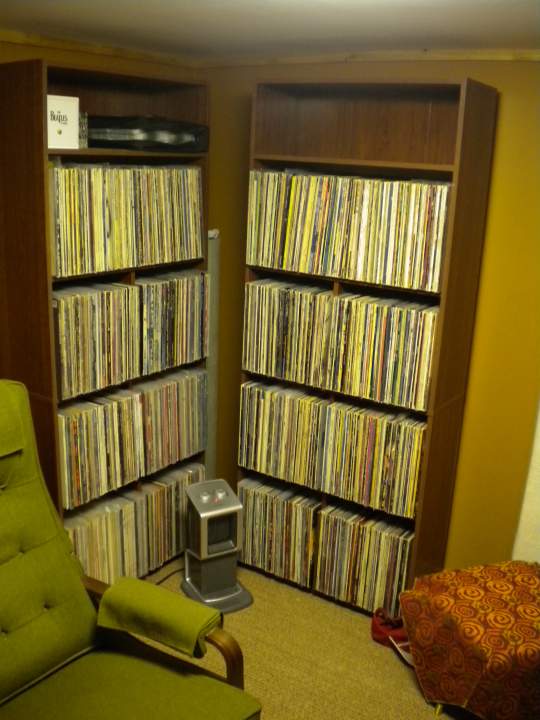

I picked two CHEAP bookshelves at Big Lots for $29.99 each and did some beefing up to allow them to hold Viynl LPs
I added 1/8'' Masonite hardboard to the backs with 1" screws (pre-drilled of course so as not to split the junk they're
made off). Then I added 3/4 X 1 1/4 pine strips to the hard board as shelf support and lastly I bought shelving and cut
them as dividers which add support because the shelves are 28" and would surely sag if left unsupported
I figure both should hold roughly about 950 LPs.........Bill

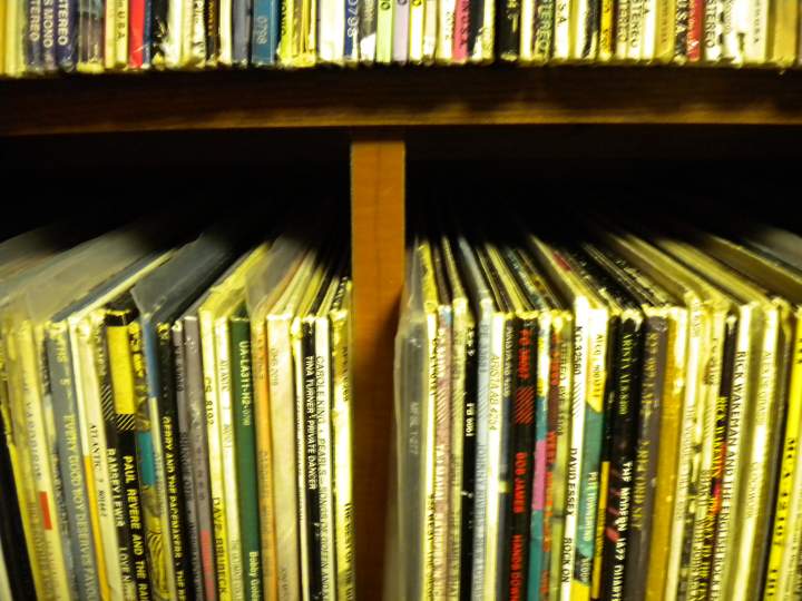

I see we got a close up of the '70's shelf.   :wink:  But Tina Turner next to Carol King?  Maybe you could also clue us in on your sorting parameters.
Seriously tho Pman, very inventive, looks like something I would put together.  Good job.
Is that a cassette tape case on top?
Elizabeth

Sorting what sorting I just emptied the boxes into them for now  :duh:
No cassettes anymore that case is for CDs

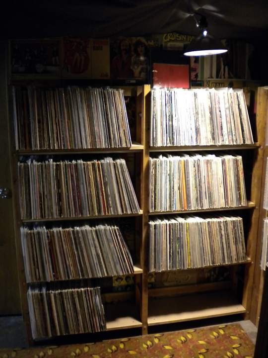

I have actually cleared out a few LPs myself. I have at this time 5000 plus LPs most are in DIY shelves made from 2X3's
EMT and MDF with a hardwood strip to dress it up a bit. These shelves were cheaper and easier since Double Decker has
become my 2nd home. CDs are housed in pine shelves that I made last year.........Bill

A small section of my DIY shelves located in the black hole my basement. The shelves on the bottom are empty as there is usually an old chair there for my good friend Rascal the dog.............Bill
Letitroll98 this section of LPs are alphabetized and in order  :lol: :lol:
