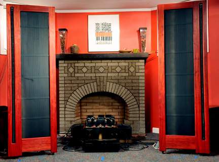

This is an old picture, as I am doing a lot of rearranging now.
My room has truncated corners behind the Mag IIIa's.  The outside edge of the speakers are about 2ft from the walls and about four feet from the plane of the front wall. Ribbons on the out side and are now toed in about 2 inches(less than in the pic).  Room is 12 ft wide. My seat is about 7ft from the center of the panel.
Most of my listening is small ensembles, jazz and chamber music or solo performances and this set up works well for that.  Large groups, big bands, orchestras I would probably wish I could rotate straight.  Need big motorized turntables with remote control to adjust while listening. That would be a hoot
flintstone
Re: Maggie Placement: A Matter of Inches?
« Reply #13 on: 9 Feb 2011, 04:46 pm »
pelliott321 ...............very nice frame build, outstanding looking. I usually don't care much for most of these (the PG builds anyway) because they look to much like a big picture frame. (although I understand the quality of sound part regardless).
If I was Peter Gunn, I'd copy your design  :green:

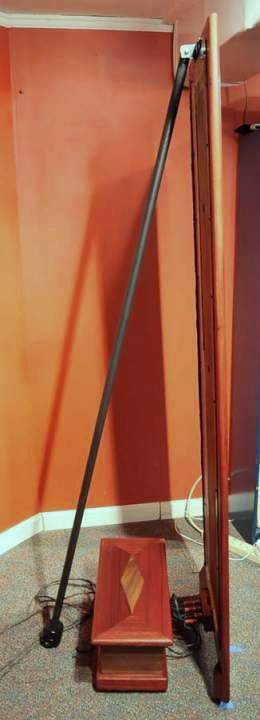

« Reply #14 on: 9 Feb 2011, 06:10 pm »
thanks for the kind words flintstone.
funny story:  when I published this picture over at AA/Planer PG commented that they looked funny.  These are made out of Paduak and are joined with pocket screws and glue. The main difference in design is that I did away with the big heavy base that his design uses. I always thought the purpose of an external xover was to get away form vibrations, so I chose to spike the bottom corners and use a support pole from the top relying on the tripod form and put the xover box spiked to the floor also.  It works well, very steady, free from vibrations that you can feel
