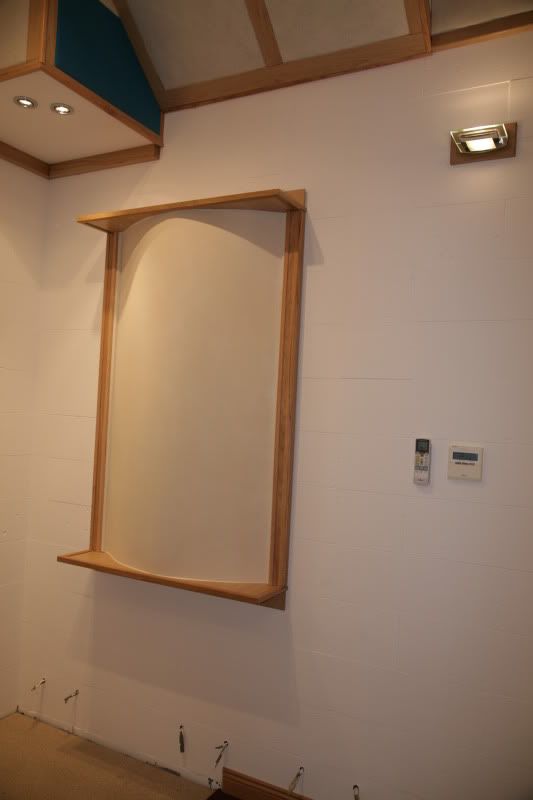

steve2701
  • Posts: 49
  • Isolation perfected.
    • Sonority Design
Re: bass trap
« Reply #3 on: 19 Jan 2011, 02:38 pm »
A couple of things come to my mind here - I'm sure Ethan will say if this is wrong though:-
If these are corner traps in front of your listening position then I wold think covering them with ply should be ok - but the ply really needs to be lightly glued to the rockwool (carpet spray glue?) as if there is a gap left then it could resonate causing you more problems?
If this is a rear corner trap behind the listening position then I would at least try listening to the trap uncovered first as you dont want to be reflecting mids and highs to your listening position with the plywood.
3' is a great size for the trap.
These are mine - I like oak  :)

I'm coming out 3ft from the corner and covering walls with rigid fiberglass and was going to cover opening diagonally with rigid fiberglass with an 1" air gap and then cover that with the 1/4" ply, I also was going to put a layer of rigid fiberglass on the top and bottom of the inside of the trap.
Again, I don't know what opening you're describing. Bass traps need to be much thicker than one inch. The thick corner traps Steve showed are one great way to do it.

Ok, finally got some time off, so let me start all over again Here is a floor plan and some pics. I want to put a trap in the left corner above the cabinet, after you comments and suggestions I'm going to put 4 layer of 1/2" fiberglass (that is designed to suppress sound in large air ducts, it is about 70-80% as dense as 703) on the walls then tightly roll up some and fill the space with it then I would run 4 layers across the corner diagonally and cover with same canvas I covered ceiling with. The frequencies I need to handle are 50-65hz and 18-25hz as a newbie I greatly appreciate the help up to now and any further suggestion. Also I was wondering if I could use that pop out window, on the right side, as some kind of trap?

Here is pic of bass trap. The window I was talking about is the one that is popped out ( see floor plan and new pics ) on right side of room.  I thought I could make something that was removable, but as window is for light only, no real view, it could be left in most of the time  The ceiling mounted speakers are not used in the main system they are for my wife's system.
« Last Edit: 27 Jan 2011, 11:01 pm by mikeeastman »
bmckenney
Re: bass trap
« Reply #18 on: 29 Jan 2011, 05:00 am »
That trap above the kitchen cabinets looks like a waste of time to me, as in not very effective.  And it will wreck the look of the kitchen cause it looks f-ugly.

Its not a kitchen it's a studio/office/music room. When I finish trimming it out it will be hardly noticeable.It must just be my imagination that it seams to have helped, but I will know more when my system get reEQed.
