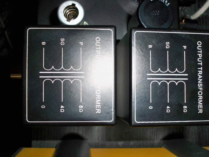

Transformer coupled could mean there is an interstage transformer between then input stage and the output stage.  Or the input itself could be transformer coupled to the 6AU6s.  Found the Canadian website but this amp is not listed so I could find no further info.
You could pop the bottom cover off and snap a couple of photos to post in this thread and we might be able to see what the circuit topology is.  If you are interested.  Obviously it satisfies the boogie factor and that's what matters.

6 watts gets loud, plenty loud....JakeJ I appreciate your time but I'm not sweating it, it is what it is, sounds good and thats all I care about. Its supposed to be a my new/old headphone amp but I had to hook it up to some JBL's...it works, sounds great...Thanks TrungT!!!!! :thumb: :thumb: :dance: Rolled in the JJ's before I even hooked it up...LOL....Good stuff, now I just have to figure out hooking up my sub...I should be able to take the SS output from the DAC/Pre and use it but for some reason the sound gets mucked up..will think while I listen....

Thanks for the photo.  Now I see it does have output trannies thus it is not an OTL amp.  All cleared up for me, thanks!
Is it possible the Headphones out are a different path and are OTL?

Yup, most definitely a possibility.  Say, eclein, do the speaker outputs turn off when a set of cans are plugged in?
