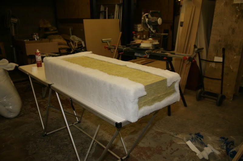

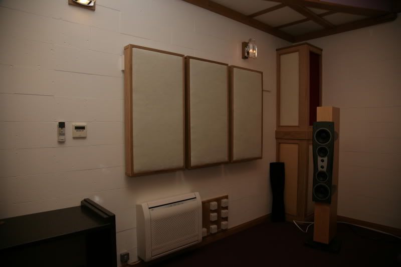

you can't just wrap 703 and slap it on the wall and expect it to give the same result as the commercial product.
Actually you can - it just depends on exactly what you want said panel to be.

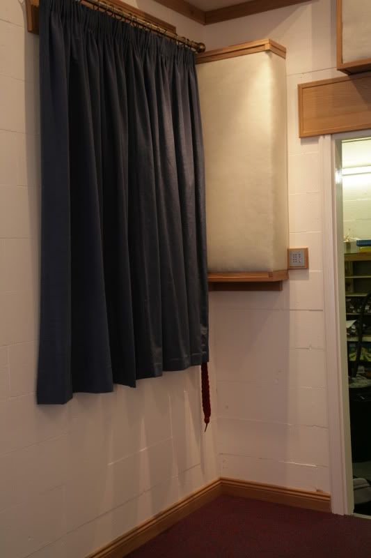

A 2" thick piece of '703' wrapped in open weave cloth makes a great first reflection point absorber ( but would do zero for bass) where as 2 x 4" thick 705 stuck together and wrapped in open weave cloth (if placed behind the listening position in a corner)  or faced with kraft then material and put into a front corner makes a great bass trap.
Rear corner bass trap - 2 x 4" thick '705' wrapped in cream muslin:-

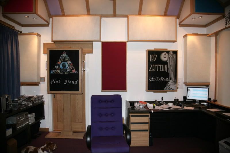

You can always make them plain or rather more interesting as well:-

Nice trim! Do you have a carpenter on staff or are you the trim carpenter?  :thumb:
This gives me some ideas on my room. I was thinking the main reason to have a frame around the fiberboard was to keep it from sagging and offer a good mounting surface. But caps could accomplish the same thing.
Is there more frame behind your corner bass trap under the muslin? How is it attached to the wall?

Honestly - it is as difficult as you make it, while I am said 'trimmer' this is the first project like this I had ever undertaken - and it grew into something rather more major than I ever imagined - but the results, largely thanks to Ethan, are just what I wanted.
With regard to fibreglass becoming floppy - well they do if you go below '703' in weight, and they need some extra support. 703 and 705 have not moved at all - even when placed at an angle of 35' off vertical.
To cover the corner bass traps I used 2 pieces of 705, very lightly glued together with spray glue, covered the visible area with 2" of white polyester (no acoustic impact whatsoever) this helps with two things - hides the colour of the rockwool and also helps ease the fabric covering it.
They are merely placed on a 3/4" mdf shelf, then faced with the trim - which extends 3/4" over the rockwool to help hold in place. The same was then done at the top. It hasn't budged in 2 years.
Making the trap:-
Garth - you really need to just read a little more and you are there if you have a little bit of diy skill, honestly.
The reason you put a space behind a trap is so that it is slightly more effective at lower levells - ie, you are getting more trap for free by spacing away from the wall.
My first reflection points were made to do a little bit for high bass as well as the highs, and also to be adjustable in placement:-
if you want to see the whole build project and all of the traps and how they were made :-
