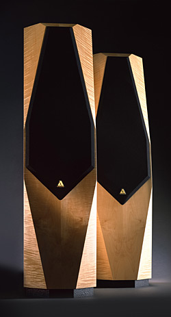

I don't mind the look of the HT3's at all, but would something more like this be doable by chance?  A lot of folks (myself included) love the slender width but longer sides.  A side-mounted woofer like the SoundScape's would be necessary, though.

As for Dennis' idea of using Jeff Bagby's radiator version of the woofer section, it is considerably deeper than the current HT3 woofer section.  So building it this way would require changing to a two-piece design and it would end up costing only slightly less than the SoundScapes.  I'm not sure people would opt for the HT3's under this scenario since the SoundScapes would only cost a bit more.  But we are certainly open to doing it.

I've always like the angled fronts of the Avalons but would think a nice bookshelf with that sort of shape would be a very hot seller.  But then the added labor and fixturing to do a small speaker may not make sense.

Jim sent me a cabinet a few years ago that was constructed almost identically to the Avalon shown.  It was full of diffraction effects and just didn't work out.  It may work better with the Avalon drivers, but I don't think Jim would be anxious to revisit that approach.  If you want the mdf prototype--it's ready for pick up in Bethesda.  I'll leave it out front.
