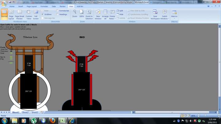

Neo 3 and Neo10 baffle options: Tibetan lyre, or RKO
« Reply #13 on: 4 Jun 2011, 05:23 pm »
I thought there'd be the option to upload a  'Paint' file . .
rick57
Re: Boxsim english version - your free Xmas gift
« Reply #14 on: 4 Jun 2011, 05:29 pm »
Black is the rectangular Neo speaker drivers
The idea is to not look rectangular; but like a slightly old fashioned musical instrument (lyre) or a 2D image (inspired by the 1930s' RKO Pictures logo)
rick57
« Reply #15 on: 4 Jun 2011, 05:37 pm »
(It will sit on top of a conventional U frame 15" Lambda woofer, so that the tweeters are at ear height).
