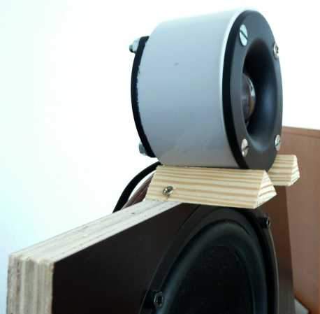

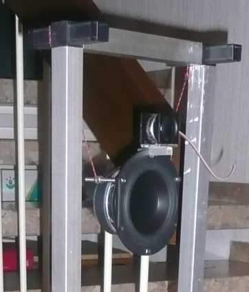

« Reply #15 on: 6 Feb 2011, 12:16 pm »
Rudolf, that's quite ok for domes. Could you please post a pic of the arrangement?
The tweeter dipole consists of two Monacor DT-25N www.monacor.de/typo3/index.php?id=84&L=1&spr=EN&artid=3574&typ=u&hkatid=&ukatid=&brand=
The tweeter dipole is 6.6 cm in diameter and 4.2 cm deep.
Next iteration is a swinging system with Peerlees HDS-PPB 4-25/08 and Dayton ND20FA-6 tweeters. The tweeter package is 3.3 x 3.3 x 3.0 cm:
Measurements of this package had been presented here:
http://www.diyaudio.com/forums/multi-way/161299-directivity-dipole-tweeters-4.html#post2125177.
