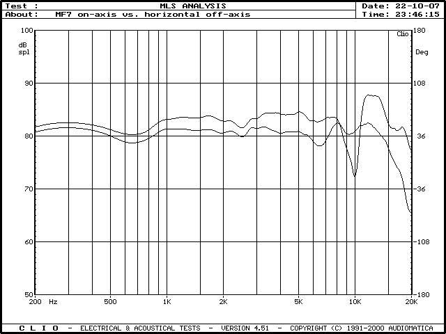

Here's the woofer btw, take 30% off for Seas dealer price.  https://www.madisound.com/store/product_info.php?products_id=1615
I've used those drivers in the past btw, and they're average at best.  The tweeter measures like a roller coaster and needs multiple notches if you're going for anything resembling a flat response ... the woofer part is decent, same as any Seas Prestige line.
For 4 g's I'd at least expect the Mag cone version.  https://www.madisound.com/store/product_info.php?products_id=8494
Von Schweikert jumped the shark on this one.
The tweeter's response is from reflections off the cone - much like a waveguide or horn. Moving the measurement mic will show the diffraction changes at different angles so the key is what the overall composite response is. Multiple notches are not the answer. The whole point here is having even coverage both vertically and horizontally.
I've used plenty of waveguides loaded with dome tweeters, none produce the FR problems of the Seas co-axial.  I don't know if you've personally worked with that driver or if you know, but the tweeter assembly is removable ... it tests nearly as poorly when placed on a flat baffle as it does in the center of the woofer.
You are right, multiple notches aren't the answer ... choosing a better driver is.
Yes, more problems with horns and peaks/dips; however, a waveguide still rolls off the top octave. Here's the on-axis vs. off-axis (30 degrees horizontal) of the MF7:
At 30 degrees horizontally you can see that the response fits a pretty tight window and has good extension. The difference in the on-axis and off-axis indicates diffraction (either the cabinet and /or woofer cone).
Are there better drivers available? Yes, but for certain applications the MF7 is a good alternative. For a center channel it has better coverage compared to a standard horizontal MTM when there's a limit on shelf height. The L/C/R front three channels can be exactly the same and offer better vertical coverage if placement height is limited (such as a wall unit, etc).
