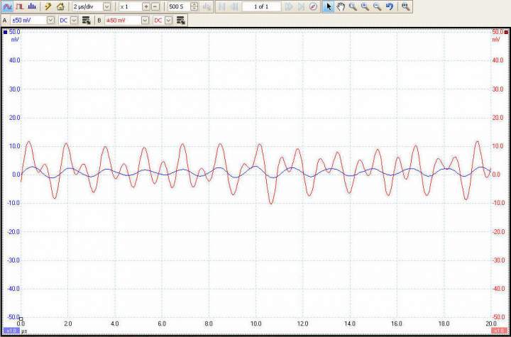

Here is a vibration graph of a pair of 1/8"-thick steel plates (6"x6") on an MDF shelf of a stereo rack with a Sonic Frontiers SFS80 amplifier on a separate shelf playing pink noise at -24dB through AR Classic 30 loudspeakers. The red line represents the vibrations of one steel plate sitting on three 1" diameter x 1" tall solid carbon cylinders. The blue line is the vibrations of a steel plate sitting on four Tenderfeet (unavoidably, the following graphs also include some degree of electronic "noise" and EMI):

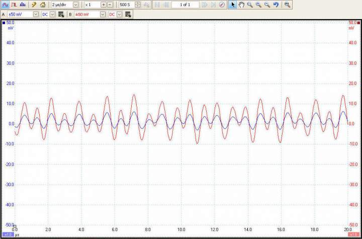

In this next graph, the steel plate is left alone (red line). On the steel plate sitting on Tenderfeet (blue line), a pair of Herbie's SuperSonic Stabilizers is placed on top of the steel plate:
Magic?
