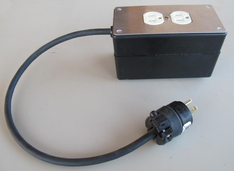

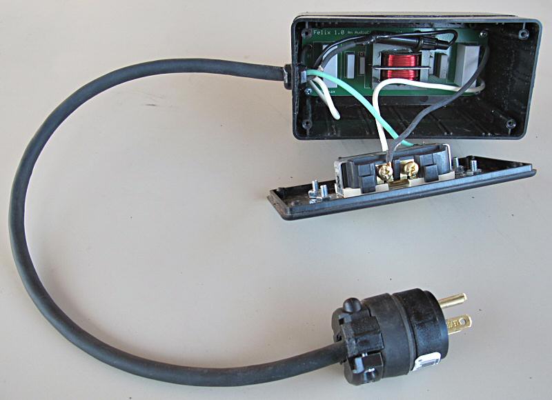

I made 4 Felix's, here is the version using the CoilCraft P3717-A 27mH CMC and the Vishay F1778 X2 caps. The box is made from 1-1/2 Radio Shack 270-1805 6"x3"x2" plastic project enclosures. I cut the 2nd box on a band saw and joined the two together with screw pins and ABS plumbing glue resulting in a strong ghetto box. The exotic 14/3 wire, Leviton CR15 outlet, Leviton plug, in-line fuse holder and 3A slo-blow fuse was sourced from my local Ace Hardware.
The Felix allows low level detail like room depth now emerge from the background. Instruments now have more space around them and the living room's front wall disappears, cymbals shimmer and decay naturally. Digital music is smoother which means it can be played louder and vinyl is magical with instruments and vocals floating in space.
Wayne

WGH, TomS - Very nice, straightforward builds. Its interesting that everyone posts pics that obscure where they've fused/breakered the filters with inductors rated for less than 15amps...  :wink:
EDIT: I need new glasses. Wayne has cleverly implemented his fuse with an in-line fuse holder.

I also built a number of Felix's in a Welborne Gatekeeper case that also had filtering.  As Wayne mentioned, it seems to lower the noise floor.
Occam, you'll notice separate fuses for each Felix.  :wink:

Thanks Sonny!  I don't remember exactly how much the project cost as it was done a number of years ago but I ordered all of the parts through the Felix group buy.  The circuit board was nice to solder and align the parts but you can still build a more compact version by soldering the parts directly together, which people have done.
And it's even on the hot lead.  :wink:
