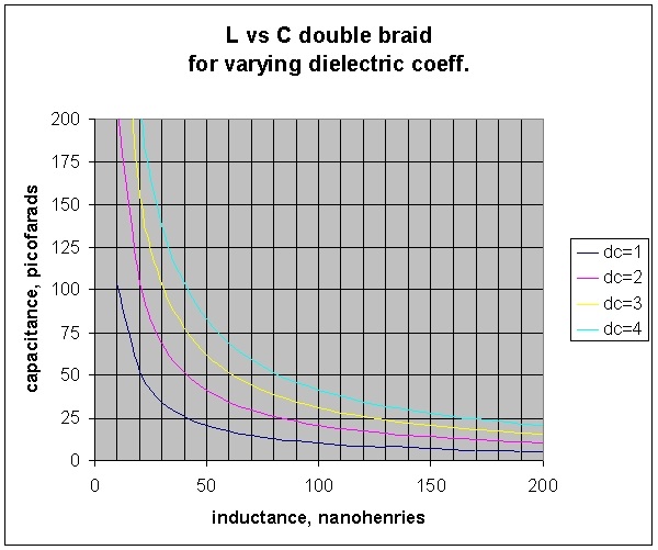

This graph depicts the tradeoff between L and C for all cables.  To wit, this particular one is of a coaxial braid pair, so there is no internal inductance to speak of.
http://www.audiocircle.com/image.php?id=11638
The lower the overall energy storage of a cable, the lower and to the left the line gets...the EDC=1 line (dark blue) is lightspeed, nothing can exist below that line.
The higher a cable gets away from the origion, the slower the cable.
It would "behoove" all to use a graph of this type to locate every cable, and how it sounded, for all speakers.  That is of course, a very long emperical path, I prefer the analytical one of course, so post the technicals so others can do that.
Cheers, John
