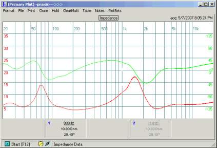

It's more complicated than just the impedance, isn't it, when phase angles are involved?I have a vague notion what this means but I'd love to hear a layman's explanation of phase angle.-Mike
Yes, speaker impedance is a very complicated animal. Usually speakers will have a large spike in their impedance at resonance frequency then slope downward, only to peak at high values as the frequency rises. The 8 ohm rating is sort of an average, but really is not the true characteristic of that speaker. As an example some 8 ohm speakers may actually dip down to 1 or 2 ohms at specific frequencies, and that is getting real close to a short circuit, which will raise hell with driver devices (tube or SS).Wayner
