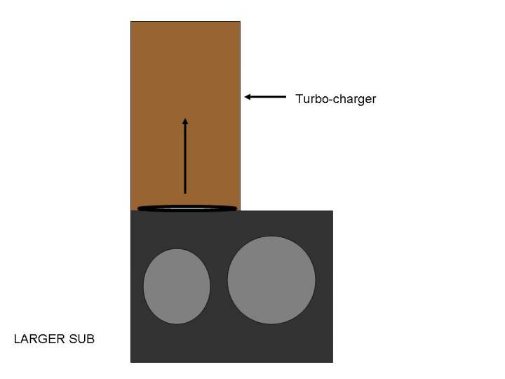

The TuboCharger consists of the following steps:
1) Reorient the LARGER SUB so that the active drivers are firing toward the listener and the Passive Radiator is firing toward the ceiling.
2) Take a tall cardboard box (I used the box for my LRC that is exceptionally heavy duty and stiff) and open both ends so it is an open tube.
3) Place the box over the Passive Radiator so that it restricts and directs the PR's output upward toward the ceiling.
That is essentially it. :green:

Here is a simple diagram of how this is set up
