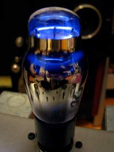

Talking about nice glow, what about the OB3 tube, I think it's called a regulatior tube.
I only saw the nice glow on picture, anyone have that tube in his audio stuff ?
Have a nice glow !
Guy 13

I have used these! They are very nice- but I found better alternatives.
