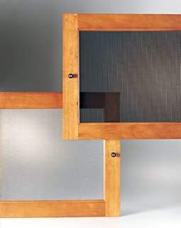

I would personally avoid the glass doors and go with perforated metal doors (wood framed with perforated metal inserts) for less sound reflection and better equipment ventilation.

The dark perforated metal will hide the components as well as medium tinted glass (unless you're talking about super-dark tinted glass) and also allow for remote use as well as not reflecting room light or sound back to the listener/viewer.
As long as the speakers are forward of the rack, I don't think the cabinet sides are too much of a concern.  They could always be clad with an acoustic panel if sound reflection was a problem, and you could first experiment with draping a thick blanket or rug over the sides for comparison.

Well, the metal is less sonically reflective than glass, and the perforated metal less so than solid metal, and they are designed to work well with IR remotes.
Although I'm sure there are other manufacturers who use the perf metal, the ones I have seen are from Salamander.  They come in any configuration, from single, double and triple wide as well as 2, 3, and 4 shelf high in a variety of furniture styles.
http://www.salamanderdesigns.com/products/av.jsp
Steve
Salamander Synergy cabinet with perforated metal insert doors:
Perforated metal door to frosted glass door comparison:
