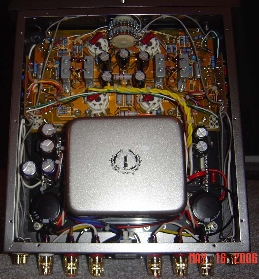

Unfortunately it doesn't look that easy to work on -
http://www.audioholics.com/reviews/amplifiers/onix-melody-sp3-tube-integrated-amplifier-review/Insidefull001.jpg/image_view_fullscreen
However, I'd suggest at least just making sure it's not a socket by cleaning and inserting/reinserting tube each a few times. While I wouldn't actually recommend it, you can sometimes find a loose socket by wiggling the tube from the top while the amp is on (small signal tubes only)...
If you are going to open it up, I'd first try bypassing the attenuator to see if that's causing it - there are a lot of joints in that.
By the way, how do you know it's not the ICs? Are they shielded?
John R,
Thanks for the link - it's helpful to see the guts of the amp.
I pretty much tried all configurations of all my IC's (monster, cobalt, onix, audioquest, purity labs) but no help.
