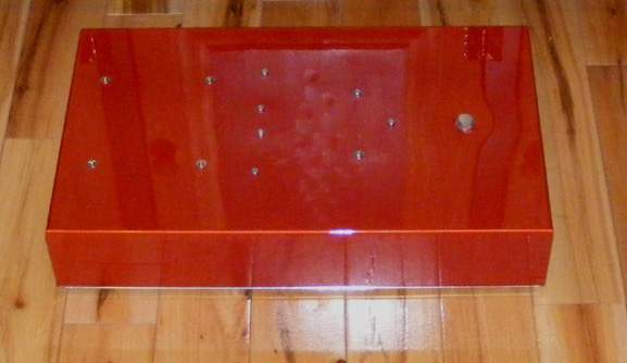

This is a photo of the base model SS-500. Color shown is Durango Copper. I noticed they loaded the wrong photo.
Other options include wood sides, a wood wrap or the complete wood enclosure as shown.
