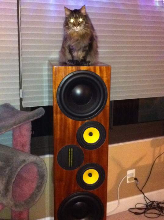

Here is the solution to the problem of the jumping Demon cat that I resorted to.
This was a radical step that may not be appropriate for all households but it has worked for six years so far,knock on wood.
Scotty
