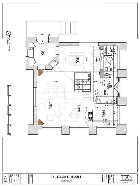

i could be wrong, but i don't think dipoles would work well when jammed into a corner like that, in that huge room.
Hi yes, looking at the photos it looks like that but cbr also said they are 4' out in a post above. My thinking however I think is similar to yours, that moving them away from the walls and closer to the listener would at least enable them to perform better and/or see what difference it makes. I'd be afraid of buying a whole new set of speakers and finding that they are going to end up being moved anyway.
cloudbaseracer - to save guesswork, perhaps it would be worth doing some measurements of the room response of the speakers? That would give you a better handle on what the issues are and also see what improvements you do get with treatments. You have a DCX in the system so applying some eq if necessary would be possible I expect.

Wonderful space, but it looks like your asymetrical symetry is going to kill your sound, and bigger speakers might not be the whole answer.
The left speaker against the wall will only have worse reflections by going with a bigger more powerful speaker with greater directivity with the right speaker out in free space with no reinforcement.
The reverb must be considerable.
Is it possible you could go with a CORNER placement (corner loading) so that the Mains are symetrically placed with equal distance and angular relationships to the side walls, while the corner loading reinforces your systems capabilities?
Corner loading would also have enough asymetry to break up a lot of other sonic problems because the distance and angles of the sound hitting the opposiing walls and even the ceiling will be "unequal" in distance and angle.
And instead of looking for speakers then that have increased constant directivity, you look for some that actually beam a bit.  That will reduce side reflections.
One sub in that corner should then be quite sufficient.
It would also give a wider "viewing angle" to the Flat Screen.
If you were going to stick a "live combo" in that corner the best seats in the house would dead center disecting that corner.
Just a thought.
That is what I was thinking too.
