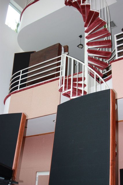

Without addressing the acoustic space - non of the above.
But the most realistic experience I witnessed took place here:
Are those things behind the MBL's acoustic absorbers?  Surely, if they are, they would defeat the omni-directional effect, if not purpose, of those type speaks.  Am I missing something?
Mariusz
Re: Most realistic speaker type?
« Reply #53 on: 2 Oct 2010, 08:07 am »
No, those are ALL SoundLabs - old, new and anything in between. I think he has the collection of them all.....and some custom ones as well. The MBL are the least favorite speakers according to Ralph.
(He uses them for ambient effects only)
There SoundLabs on the 1st and 2nd floor as well.
