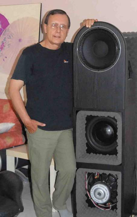

I also tried with and without the foam around the subs and could not see a big difference or even a small difference in sound. I will do more testing with the V-2 since they don't have yet the foam installed.
Like I had mentioned earlier, everything that I have read about egg crate foam is that it is nearly worthless for deadening resonances. Your experience reconfirms that.   A recommended DIY method is a layer of heavy flooring vinyl next to the cabinet followed by two layers of carpet padding ( you may substitute any dense open cell foam, but the density is the key).  Perhaps you can find a business that ships electronics or optics that may have a supply of dense open cell foam that they use for packing materials.  Best of luck with your project.

Like S Clark mentioned, a layer of foam isn't going to do much. It will absorb standing waves, but the wavelengths being produced by the woofers are too long to create any standing wave issues. And it will do nothing to control the resonances of the panels.
Guy's version will also be considerably more resonant than typical as he strayed from the original design plans and omitted the side panels that further stiffen the lower cabinet and reduce resonances.
Lining the insides with heavy floor tiles will help.
No Rez is actually a composite of vinyl and asphalt, and the sheets are 24" by 27".

You built the V-2 cabinets so much too big that there is a lot of extra space around the lower subs and the side walls. You can actually tighten up the bass response quite a bit if you line the walls front and back with 3/4" MDF. That will stiffen them up and keep them from resonating so much.
Hi Danny.
If inside the sub H frame around the driver's walls I put some No Rez will it do the same as 3/4" MDF?
I also want to put on each side wall an extra board of 3/4" MDF. I am not convinced it will make a difference, but... You are the expert, not me.
Guy 13.
If it were me then I would line it with 3/4" MDF and then the No Rez on top of that.
