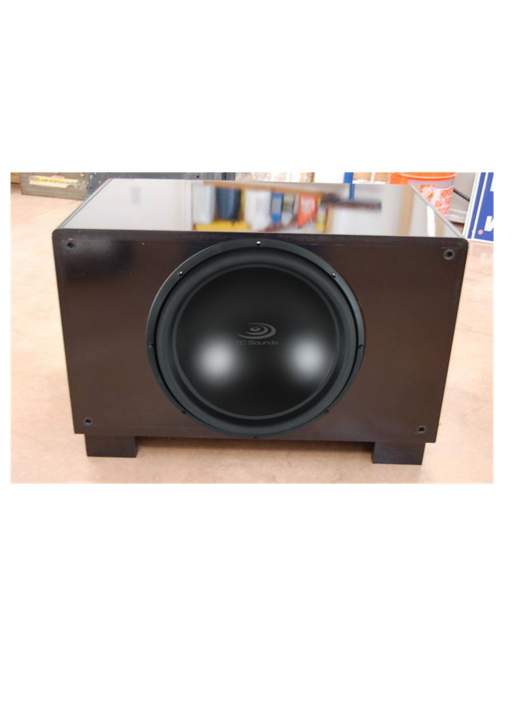

I did get this photo of the comparison between the regular 15" MegaWoofer and the OMG MONSTER.
I am told by some that they have had to esort their previous subs out of the area so that they don't get blown away by the new guy in town.

There is absolutely NO TRUTH to the rumor that the government is asking for any "substance" testing of ANY kind for our BIG. . BAD. . .WOOF.  NONE :wink:
The above 215 (which is our entry level BIG BAD WOOF) has a 15" ACTIVE OMG Driver from TC Sounds, and a 15" Passive BIG BUMP Radiator.
PRICE: OMG 215 = $1099
w/1000w sub amp = $1498!!!!

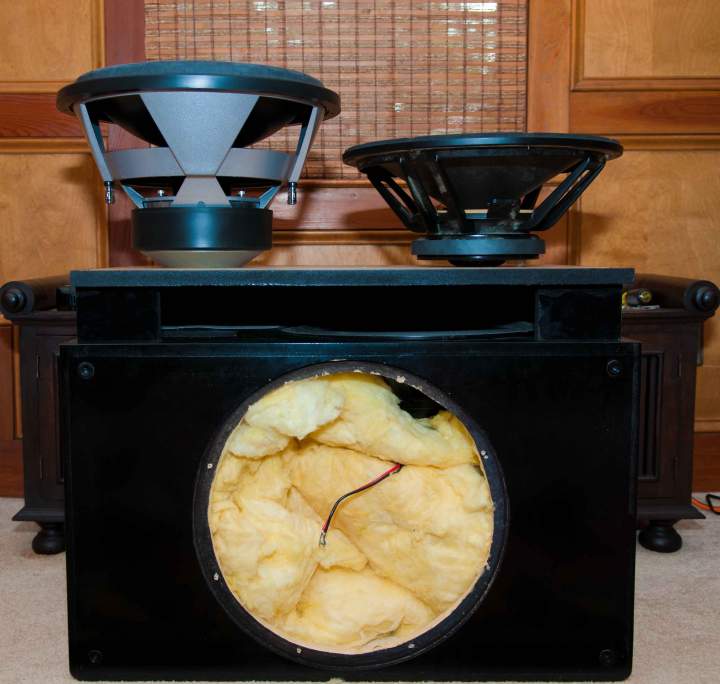

Yesterday I acquired my TC Sounds woofer and Brian's passive for my 215 subwoofer.  My room is 13' x 20' x 8'. The sub is powered by a 1,000 watt PE plate amp and is being used strictly for HT.
I installed the woofer and ran a quick demo last night and again this morning. First impressions -- this thing is brutal!!! No doubt about it. I've never
seen a woofer move so much air. If you place your hand in front of the woofer, it'll damn near blow it off your wrist. For those of you who think you already own a powerful sub, think again. This woofer makes my old 215 sound like the wimpy kid who gets beat up every day after school.
One minor issue -- I notice some noise coming from the sub during deep bass passages. It sounds like port noise even though the sub doesn't have a port. I'll be the first to admit that it could be my skills (or lack thereof) of properly installing the woofer and passive radiator (which doesn't sit flush either, by the way). I do think, though, that if this sub were built from the ground up for the TC Sounds woofer, the cabinet would need to be much stronger. There's a ton of air being pushed externally, and I can imagine that there's probably a lot more air movement inside the cabinet that the old drivers couldn't produce. This air could be rattling the plate amp.
And I feel sorry for the poor passive radiator. It's not well built and it also moves a lot of air, but it seems like it's gonna blow a gasket at any moment. Some of the noise I'm hearing could be coming from the passive's air hitting the base of the sub and back onto the radiator. I dunno. Hopefully some of y'all will chime in and help me identify the source of the noise.

I suggest moving the plate amp out of the enclosure.  It is the source of the noise you're hearing.
The PR is fine.  While the frame is stamped steel, it is damped with Dynamat and as quiet as most diecast frames, and it is stronger.  The PR has more than 1" peak to peak excursion, like the 15".  We may go to a taller PR surround, but again, the cabinet would have to be specially cut for that, not a retrofit.
Moving the plate amp outside the enclosure and sealing its cutout should take care of the noise problem.
OK, thanks Brian.
Oh, I forgot to mention that the TC Sounds woofer seems to weigh twice as much as the old driver. Check out the difference in magnet size in the photo above. It's a woofer for hard core enthusiasts, that's for sure. I don't know what it will sound like for music, but for HT, you'll need to board up your windows and prepare for the hurricane if you ever plan to turn this sucker up beyond 9am.

The TC sounds 15" weighs in at 43 lbs and has a 195oz magnet, vs 16lbs and 80oz magnet for our old 15".  The TC Sounds costs about five times as much, too.
Performance on music is excellent once you tune the PR by pinching putty.  Instructions for doing so are here as a sticky.

Just wanted to report back -- I removed the plate amp today, sealed her up, and this resolved the rattling issue as Brian indicated. All I got left to do is sit back, pop in a few movies, and enjoy my "new" subwoofer. I'll report back again later.

Madisound has fasteners with standoffs for extra deep grillframes.
In future retrofits with the TC Sounds woofers I'll make sure there is no plate amp in the enclosure.  The amp will last longer outside the box as well.
