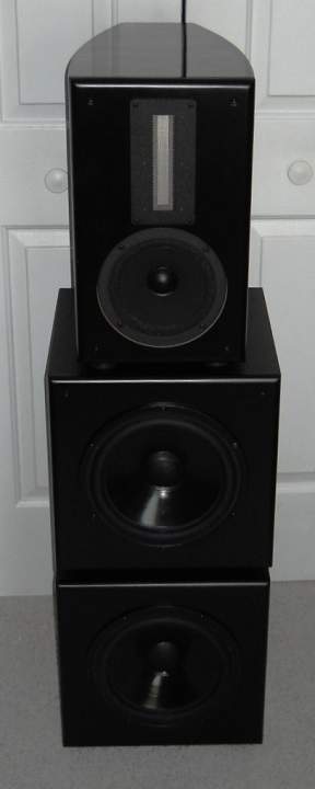

« on: 15 Sep 2010, 03:38 pm »
High sensitivity with low coloration... :thumb:

Very nice!
What's the sensitivity?  What sort of load do they present?

Is that your new flagship tower?

Re: Something Different...
« Reply #3 on: 16 Sep 2010, 10:28 pm »
Very nice!
This particular set is for a solid state amp system, 4 ohm load, 91-92db sensitivity. With different woofers (and larger bass enclosures) it could be in the 95db range and possibly a higher impedance depending on the woofers used.
« Reply #4 on: 16 Sep 2010, 10:46 pm »
No, a custom design that's in progress.
standub
« Reply #5 on: 17 Sep 2010, 01:42 am »
What mid-range is that?  How does it compare to the usual ScanSpeak and Accutrons you use?
« Reply #7 on: 21 Sep 2010, 04:13 pm »
Professional drivers to accompany the RAALS? How do you feel about using pro drivers in general  :D
The only reason to use pro drivers is for higher sensitivity. Most of them I wouldn't ever consider because the coloration levels are too high. My opinion is that good source amplification is available for powering designs with lower sensitivity and that's the superior route versus a SET and open baffle high sensitivity speaker / waveguide / horn / you fill in the blank speaker.
This particular design fills the void and the mid will allow for pro woofers to be crossed low enough to keep them out of the range where they start to break up. The tradeoff is that a pro woofer needs a much larger cabinet if you want decent bass extension.
« Reply #13 on: 25 Oct 2010, 12:30 am »
Is that an Audax 6.5" mid?  It looks a bit like the PR170M0...  Whichever it may be, do you find that it is the best high efficiency midrange that you have used?  Some months ago, you had begun a thread regarding a high efficiency system utlizing an Acoustic Elegance driver, a project which was later aborted.  Is the present system's midrange driver a better solution?  You mention elsewhere the possibility of incorporating different bass drivers to raise the overall sensitivity of the system -- this in particular is what has me curious about what in fact is this low-coloration midrange driver, as I would be keen on having you work on a slightly different three-way design.
Yes, it's a version of the Audax but with a Nextel coating on the cone to improve the internal damping. I prefer using the Audax or the 7" Accuton with the choice dependent on the sensitivity target, budget, and other drivers in the design. The AE 2-way's 15" woofer fell a little short of my customer's goal for sensitivity so that's why we didn't complete the project.
