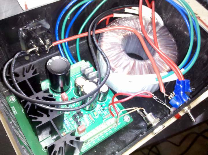

I had every intention to document the build and even reminded myself as I got the components together, but next thing I knew an hour went by and it was mostly done! That's not a good sign! I solder sling now like an old lady knitting in front of the telly!

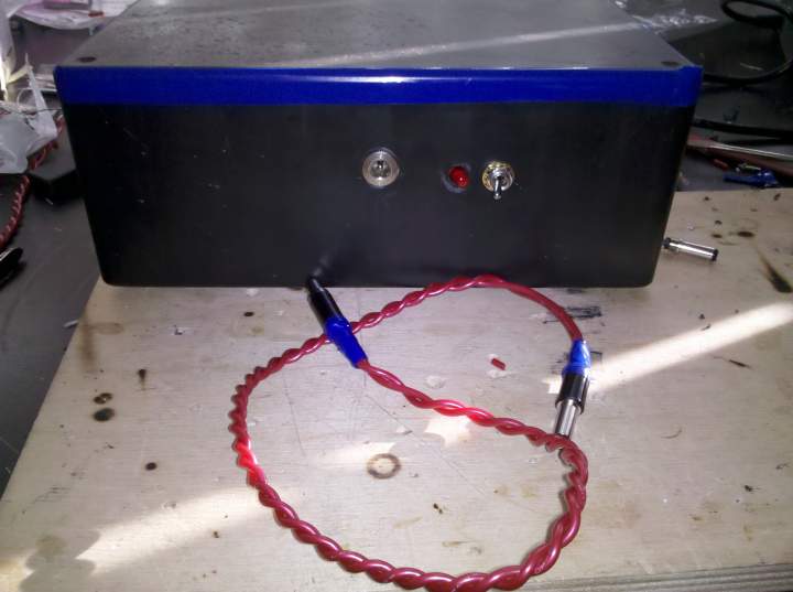

Anyhoos, I got the board itself soldered in about an hour and I took my time. There are only a dozen components. It's a very, very simple build. The hardest part was (and will always be for me) doing the enclosure. I just used an old Radio Shack project box I had lying around. The transformer is an Antek 15v.
I only have one connector so far, I'll add the other 3 when the parts get in. I tested it on the Teralink last night and it works great. because of all the crazy diy AC stuff I have I will give it a couple days to burn in/adjust. But it's worth it just be able to free up more outlets and reduce the cords.
