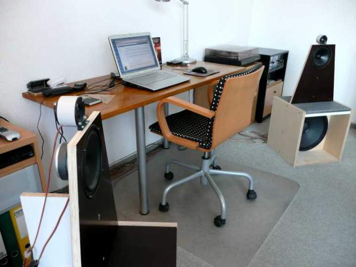

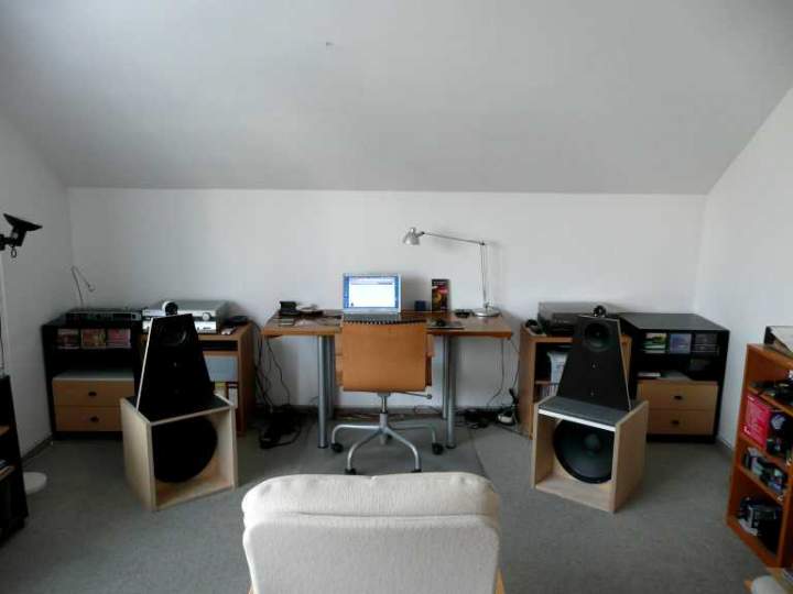

But it is completely justified to ask for my own state of art. Here we go. This is my listening situation:
It took me more than an hour to get that part of my “private” room into a presentable shape. My wife calls me a “messie”, I call it creative organic growth. :wink: So please don’t ask when I will tidy up the cable mess on the front wall.
In the front of the picture you see the back of my listening chair. The dipoles are 2.15 m apart (center-center) and it is 2 m from each tweeter to the corresponding ear. The dipole axes are meeting 20 cm in front of my ears.

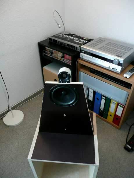

Two more perspectives:

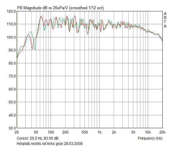

What my ears hear, looks like this (right is red, left is green):
I credit much of the congruence of both channels to the symmetry of that room side. You may have noticed how the furniture is mirror imaged.

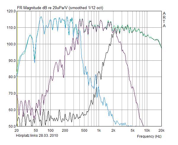

And this is the way how it is distributed to the drivers:
Crossover from the H frame to the mids is 300 Hz, mid-tweeters is just above 2k.

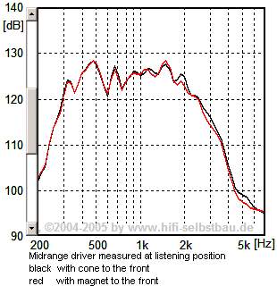

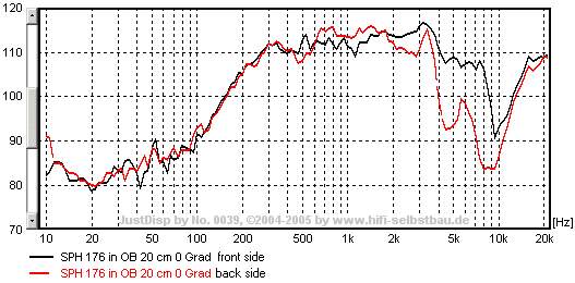

Drivers are A&D 15308 http://www.traumboxen.de/ad-audio/15308.htm, Monacor SPH 176 http://www.monacor.de/typo3/index.php?id=75&L=1&act=&act_sub=&artid=4084&spr=EN&typ=u and Monacor DT-25N  http://www.monacor.de/typo3/index.php?id=75&L=1&act=8&act_sub=25&artid=3574&spr=EN&typ=u. Those drivers are nothing special in general. In fact they are low cost, but they give much value for the money. None of them is made for earbleeding SPL levels though.

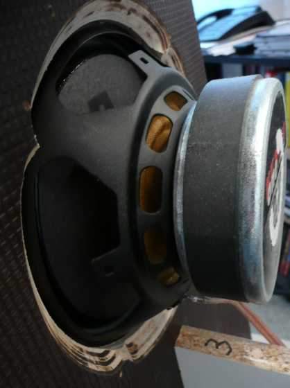

What I really like about the SPH-176 is the small size of the spider, which opens the cavity between cone and basket and IMHO is responsible for the acceptable front-back SPL similarity.
Measured from approx. 0.5 m distance:
Measured from listening distance (2 m):

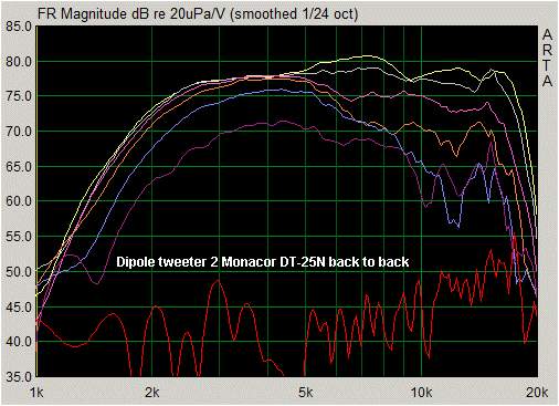

The DT-25N simply were the smallest decent 1 inch tweeters available when I bought them. As I have explained in http://www.diyaudio.com/forums/multi-way/161299-directivity-dipole-tweeters.html I try to have a true dipole response as far up as possible (horizontal polars 0-90° in 15 ° steps, taken at 40 cm distance):
Note how for all of its frequency range the 90° level is at least 25, mostly 30 dB below the on-axis level. In fact it is mostly buried in the noise floor.
