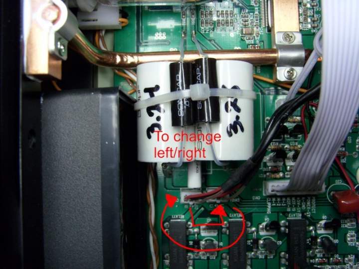

Guys,
Gary flipped the right/left channels on a few of the amps by accident.
The POT connects to the board behind the caps on Sensation.  Simply pull out the connectors, swap them and replug.  3 minutes, no soldering.
Seth

« Reply #2 on: 16 Aug 2010, 10:09 pm »
Seth,
Thanks for the information.
Now, how do I know if this is something I should be doing?  Can I tell by looking?  Is there something I should be hearing, or is it just a matter of what used to be coming from the right speaker is now coming from the left speaker?
Robb

Re: Sensation / Buffer / channels switched?
« Reply #3 on: 16 Aug 2010, 10:16 pm »
If left channel is coming out of the right speaker, you've got something reversed.
« Reply #4 on: 17 Aug 2010, 07:29 pm »
I'm about a week into listening to my new Sensation. Last Friday I decided to change the sub jumper to the 80Hz rolloff (this is the right thing to do BTW). At the same time I decided to experiment with the Sensation as a preamp. It sounded odd. So I got out a test disc and the channels were all screwed up. I had just read the post about the connector swap so I reversed them. The sound was still screwed up! I was ready to get on the phone then took a second look at the back of the Virtue. I had the right RCA output going to the right power amp input but the left channel was connected to the sub out (which gave me a full two channel mono feed to the left channel). No wonder it sounded weird. MORAL: check the obvious things first! Oh, and it sounds great as preamp but I'm back to using it as a full integrated - at least through the break-in period.
