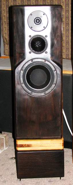

While he was in town, he thought he might as well drop off the DAR-Ma speakers that Dan Wright is going to use at RMAF this year. I have the task of breaking these babys in. Leave it to Lou to find someone else to do the dirty work  :lol:
Here are a couple of shots of the DAR-Mas in my HT.

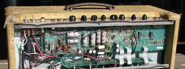

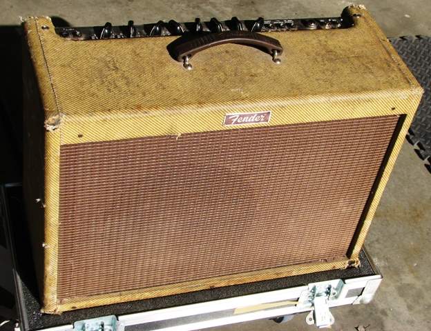

Many, many, many months ago, Lou asked me to look at a Fender Blues Deluxe he bought off of E-Bay. The original idea was for me to come up with some mods to improve the sound of the amp and he could build a new cabinet for it. The thought was that maybe here would be a sideline we might be able to make some money with.
After the amp arrived here, I found it was in much worse shape than was represented in the ad. The cabinet was beyond used. The tweed looked like it had been on the road since the '30s.
This was an amp that was built in 1996. As part of the cost savings going on at Fender, they used a couple of 5 watt resistors to drop voltage down to power the op-amps that drive the reverb circuit. The resistor had to dissipate 4.7 watts. Needless to say they ended up frying. They also took out some of the nearby circuit. Here is a shot of the circuit board. Look close for the white rectangles under the big capacitors. You can see the darkened circuit board around them
There was also a melt down with the output tubes filament circuit.

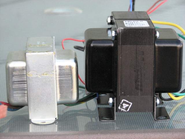

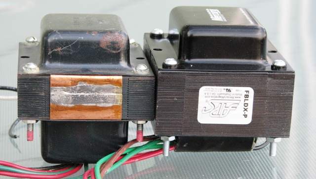

I replaced all the iron. Here are some pictures of the stock power transformer, choke and output transformer compared to the replacements.
