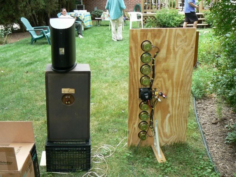

George and I spent yesterday building a pair of Open Baffle, Line Array, EconoWaves.  He got here at 11:00 and left at around 5:00.  I think we made good progress. But we were both tired when we assemble the second speaker.....can you see the mistake.  It will be fixed today when I finsh the wiring.
The drivers are PE 69 cent NSB close outs.
The horns are JBL 6"x6" wave guides with Selenium D210T
The cross overs are stock eWave
They ar 48" tall and 24" wide.

I just bored holes through the plywood and attached the drivers.  Will it change, help, or hinder anything if I champher the back of the holes so the back of the driver will be more exposed???  Thanks in advance.
It will be VERY helpful IMHO. After looking at the pictures I would have mounted the NSB drivers from the rear and chamfered the front of the holes, giving the drivers a sort of little waveguide.

I thought about doing just that Rudolf, but the hole my hole saw made was too big.  When I am totally satisfied after I do all the tweeking, I will build another pair of these with Teak and Mahagony planks, just like the old Christ-Craft's deck.

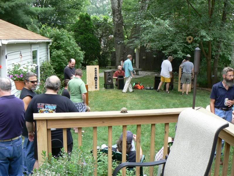

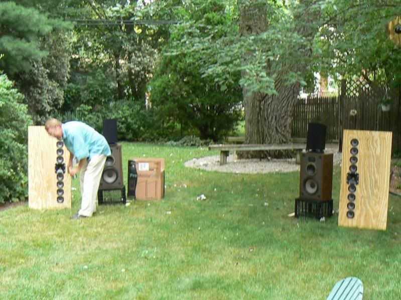

Last Saturday I brought these over to your local SMAC gathering (Southeast Michigan Audio Club) and they were a big hit.  We had another pair of EconoWaves with EPI woofers and cabs, and Polk 7s.  Neither of them played very long as everybody wanted the OblaWaves in the system.  We were driving them with Kegger's EL500 SET prototype and they sounded great.  The amp only puts out 3wpc and that was more than enough to fill the back yard.

Yep, it was nice being outside but the distance and lack of wall reenforcements made the bass (what there is of it) a little shy.  Back in the house and these things have much more bass then I'd ever imagine.
This would also line them up a bit more vertically with the depth of the Selenium's diaphragm.  I kinda like the grain of the baffles.  Gives a visual texture that doesn't rely on paint for character.
