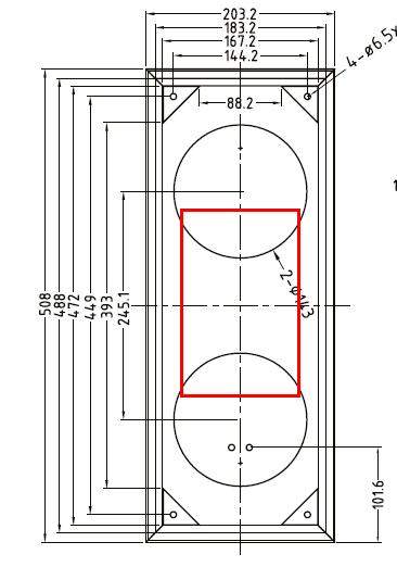

Now, if I built the N3 instead for the center, I haven't yet located the cab plans for sealed N3 - or is there a PE box the N3 could go in?  I also need to go look at the vertical off-axis numbers for the N3 as I have seen some rumblings about the MTM's on their side being not that great in some cases, although that appears to be how almost everyone else builds their centers.

When you lay am MTM speaker on its side then you will get cancellation in the off axis response when you have created a long enough time delay between the woofers that they start cancelling each other out.
The further apart the woofers are the less off axis you need to be to start seeing a problem.
On the N3 and N3S models the woofers are mounted so close to the tweeter that they actually overlap. So the acoustic centers are closer together than most, and they don't start showing real drops in output until about 20 degrees off axis. This is usually further off axis than typical seating during movies. So with the N3S this is not much of a problem.
N3S plans are here: http://www.gr-research.com/pdf/Neo3S.pdf
And I think there is a PE box that can be used with this one.
You could use a 0.75ft^3 PE box, but you have to use a closed cell foam or something else to get the volume correct.  You'd also have to modify the box by cutting out a section of the center brace to take care of an internal reflection and line with No Rez.
