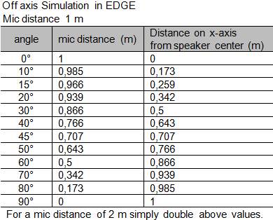

May be you would want to know the off-axis performance of your baffles. It will be quite different to both sides. My chart should be helpful:

« Reply #13 on: 9 Aug 2010, 04:51 pm »
Thanks Rudolf, however, I am not sure how to use this.  I only sit in one listening position so I really never think about off axis responce.....unless I am missing something.

« Reply #14 on: 9 Aug 2010, 07:53 pm »
I only sit in one listening position so I really never think about off axis responce.... unless I am missing something.
It's possibly in anticipation of your next loudspeaker project. There is so much more to worry about than on-axis response only :scratch:
