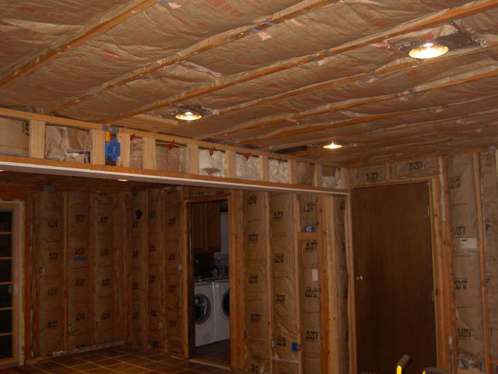

That was my point.  It's useless to buy speakers depending on room modes, because you can't tell how a speaker will interact with room modes.  But it's also useless to measure at a location your head won't be.  When I measured, I measured exactly at my ear height where I would have been sitting had the microphone not been there.  Any lower would be not useful.  Now, moving forward or backward would be a good idea, since my ears might physically be able to meet those positions.  I did measure my RM40s, but never measured the Salks due to room construction (see below for pictures of my room I took this morning).  The Salks however had a bad interaction with my room.  That's why you can't look at a speaker's rolloff characteristics and your measurements of room modes and come up with a reasonable approximation how the speaker will sound.  Furthermore, I never had the chance to move everything around, and perhaps moving the Salks somewhere else would've helped at the listening position.
