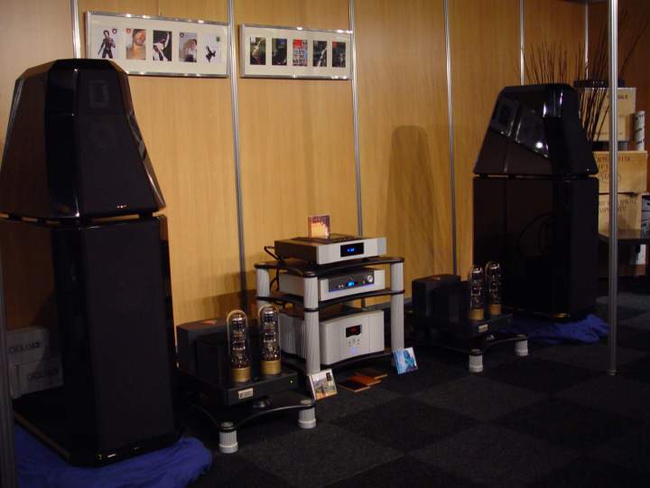

We have the VR 7 SE conected to a set of KR Kronzilla DX at 100 watt pc.
This combination is very spatial and natural. I can recomend the KR tube amplifiers.
Your VR 7 SE mk II need a few hours more to break-in. The new components need this for sure. At your level this is very important.
Show setup with PS Audio Source and Pre.
Good luck and enjoy the growing proces.
Cor
