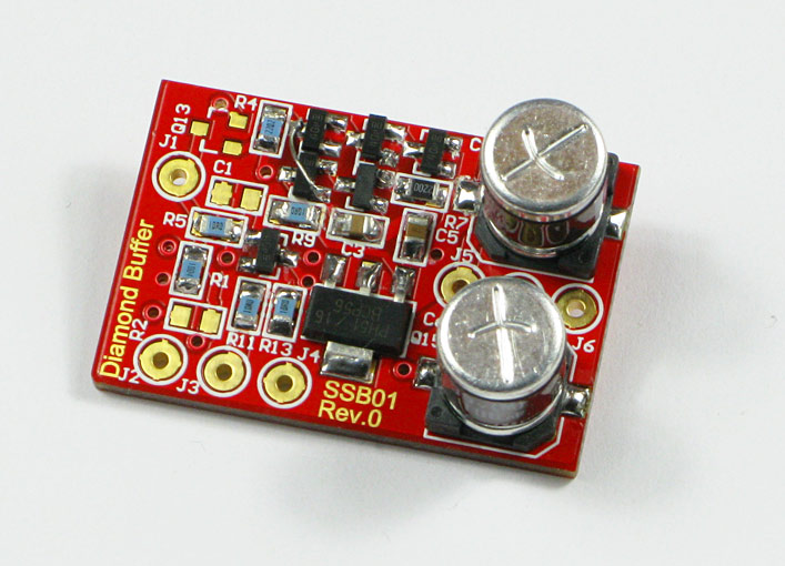

Too small? Solder SMD is your thing?
Detail of the pcb

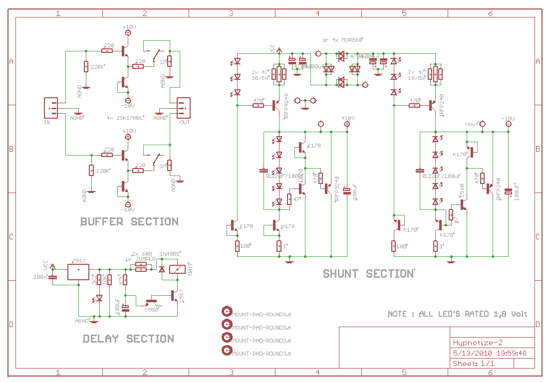

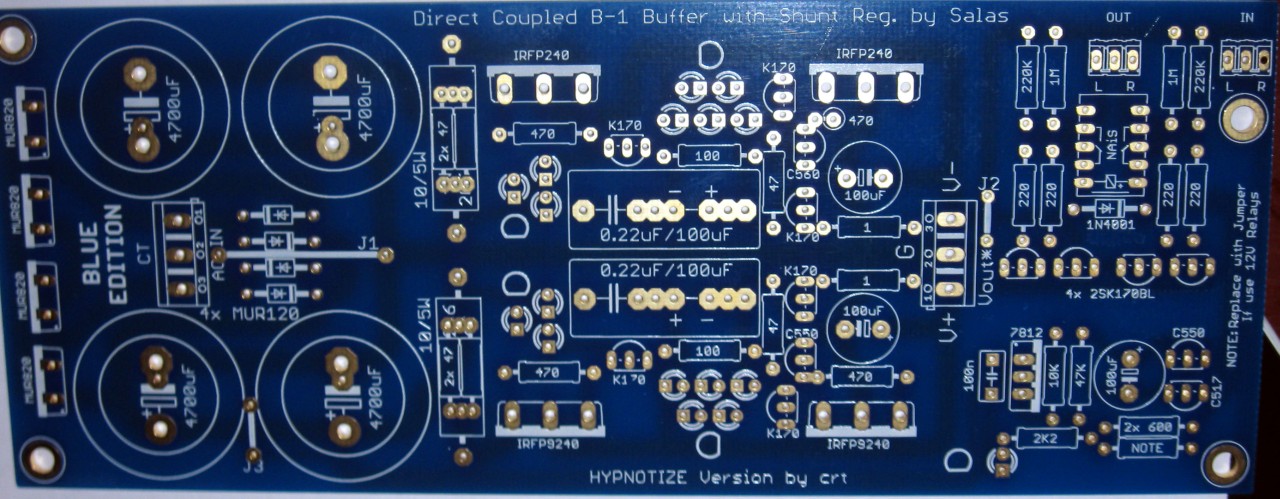

Just to throw out ideas, I just ordered Tea-Bag/Salas' DC coupled B1 buffer inspired by Nelson Pass' B1 of course. I ordered a pair, since I like differential/balanced circuits. The latest version uses shunt regulators and a 12V based relay...so if you don't want a capacitor, this is one way to go.
See here, and here. Just e-mail Tea-Bag if you want the board or boards. It's quite an elegant design and I love shunt regulators.

I just noticed that the schematic is wrong, or the designer didn't bother to use the right symbols in the shunt element. It is now a NPN transistor connected wrong but I see that a P-channel MOSFET is used.
