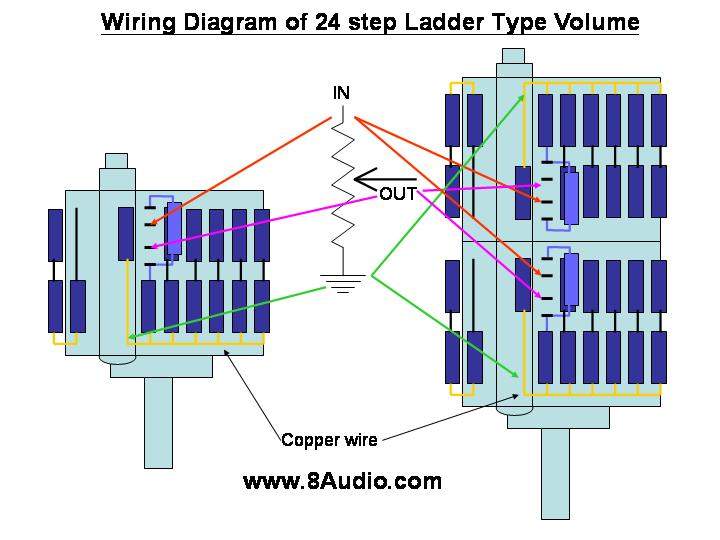

I'm using a stereo step attenuator which has tab connections for the signal wires; you then attach separate ground wires to the copper wire where the resistors are soldered. See attached photo.

Why not just attach all the signal grounds to the copper wire in ne spot?  What amp are you gonna use?

Hi Kris, since it is a stereo attenuator there is a right and a left channel so each channel has a separate ground. I'm using a Parasound 2250 solid state amplifier at least for the near future (and as funds require). The tube preamp will be replacing a Parasound 2100 solid state preamp which I purchased - along with the amp - because I wanted to be able to connect my audio-visual receiver using the by-pass circuit in the Parasound. This enabled me to use my front speakers for the AV as well as music. I've since upgraded the speakers.

So my assesment is this.  Attach the gronds to the attenuator.  Put a switch on the jumper that will connect the signal ground to earth but allow you to lift it.  Connect the earth lug under the standoff that connects the signal ground to earth.  I bet your amp has the signal ground connected to earth so ***I*** would float the signal ground in the pre as long as you are using the amp.  Rememebr everything is still connected to earth through the grounds of the interconnects.  Just test the amp to see if this is correct.  Use your ohm meter to test resistence from the RCA ground to the safety pin on the power IEC or cable.
