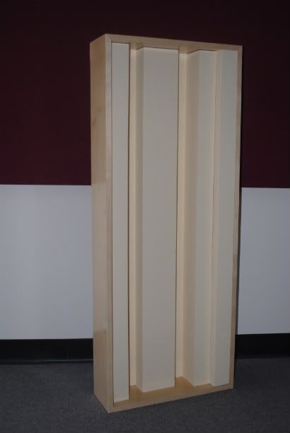

« on: 1 Jun 2010, 11:27 pm »
... I think.
http://www.amazon.com/gp/product/B0007P4IPG/ref=oss_product
I bought two rolls and it was enough to do all 6 of my panels. Worked out to maybe $10 per panel.
Undamped, the D1s are a bit ringy when rapped, and during loud music they vibrate to the touch. I'm not sure how much this contributes to the sound, but I'd think that 6 of these vibrating would be contributing something unwanted back into the room.
After applying the damping (it forms very well to the internal contours of the panel), the panels are much more inert and have a heftier, higher quality feel to them. Sound quality-wise it's hard to say, since my system has been down for a while, but you can clearly feel that they vibrate much less w/ music and ring much less when knuckle-rapped.
In my room lighting, I can't see the damping so the outward appearance is unchanged.
Anyway, I think this topic has come up in the past so I wanted to add my experience.
Happy diffusing  :thumb:
-Mike

The D1's can be done either with something soft like the Acoustistuff to allow it to provide some bass control in addition to the diffusion
- OR -
You can use something like Pete did with putty of some sort to just have diffusion.
They're left open deliberately to allow that option.

OK, some quick snaps:
I guess I could have applied a few more inches to this guy, but I didn't want to run out 1/2 way through my last panel. And it might be possible to double-wide the strips to get 100% coverage but I don't think this would be cost-effective.
Some views to see how the material lays in there nicely:
