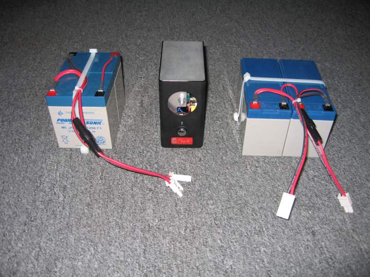

Here are the specs on the 7Ah:
http://www.batteryplex.com/sheets/PS%2D1272%20F1.pdf
There are two in a unit as you see below.  Gary had some trouble with the white heat-shrink tape we hoped to put around the unit so they'll probably go out "as-is".  It's not in a box and it ain't got the elegance of a Black Lightening (if you can afford it, buy one!), but the connectors are perfect and it's  mostly a "finished" product.  We had some logistics issues with the ABT charger (cheap) so these first few are actually shipping with Soneil.
