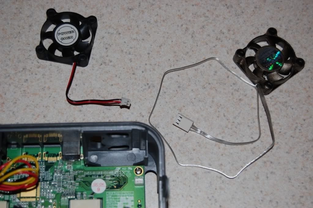

The 40x40x10 cooling fan in my double bay RAID drive locked up (no telling how long ago  :roll: ). I bought a fancy new, ultra quiet replacement model and ran into a bit of a snag. Well, two snags.
First, the new fan is three wires, the old is two. I have no problem (no fear) cutting the old PCB plug off the old jack and soldering it on the new fan. But...I know DC could be wired either way, it'll just make the fan spin the other direction. So, how do I know which two wires to use? Does it really make a difference, or is it just a matter of getting voltage to the motor in the correct polarity? Process of elimination?
I hate the idea of sticking them on the "hot" board and..... "testing" which wires in which polarity.
Second, I assume the safest bet would be for the fan to pull hot air out out of the case as opposed to stuffing cool air in?
Thanks folks. Will be nice to have tunes again. I've been without for a few days.
Bob
Here's a photo of the fans and circuit board.
Levi
Three wires on the newer fans means it can be controlled (speed).  The three pins are used for ground, +12 V power, and a tachometer signal.  You can easily splice it and turn it into 2 wires (plus) and (minus).  Since it is not color coded, you may have to refer back to the fan manufacturer.  You may have to strip it and do a trial by error.
If the fan is in the back of the unit, more than likely it is an exhaust.  So, it should pull (suck) hot air out of the chassis.

 :thumb: The soldering station is warming. Thank you Levi!!

The tunes are spinning, and the air is flowing. Thanks!!
