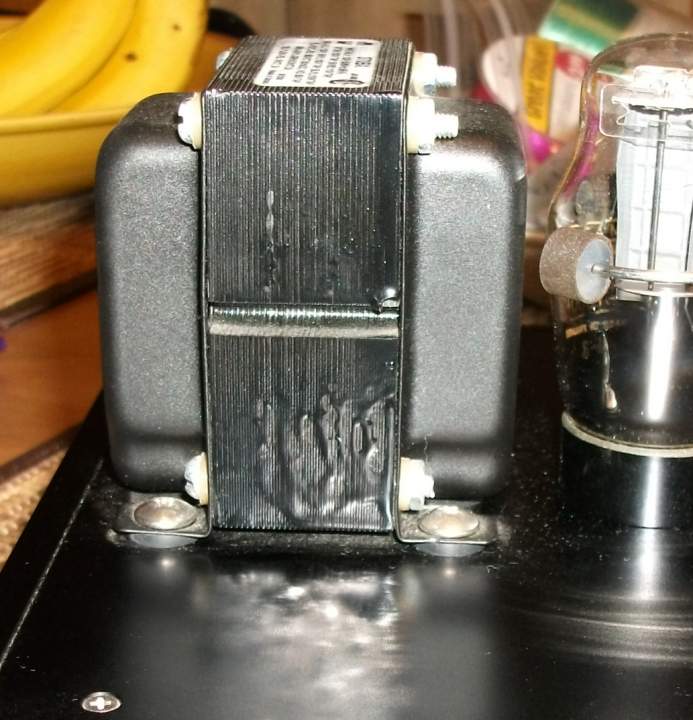

Everything looks okay inside. At first I thought the transformer might have taken a hit because of the look of it (see photo), but I think that's just the paint they glop on the outside. It looked that way before the "event" (I took a photo when I first got it).
I think we're cool. No more screwing around with old tubes unless they're thoroughly tested.
