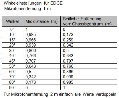

This is a tiny list of correction values for mic distance and mic offset from the speaker center which helps you to get off axis simulations:

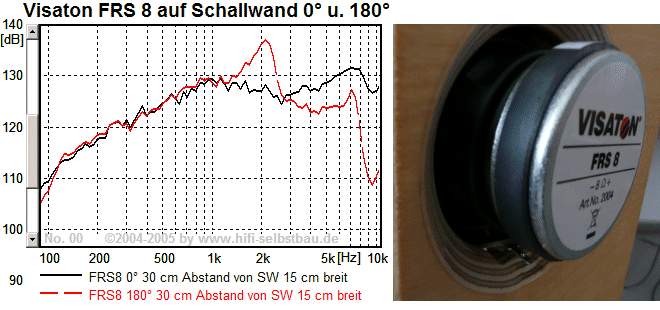

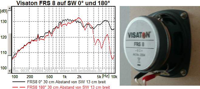

the following is just an example of what can happen. Most every driver will react differently - so you can´t take general conclusions from this.
Mounted in the usual way the Visaton FRS 8 will show a nasty resonance to the rear at 2 kHz:

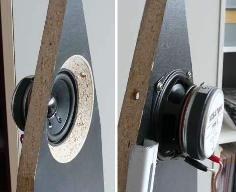

Mounting the driver to the back improved things remarkably:

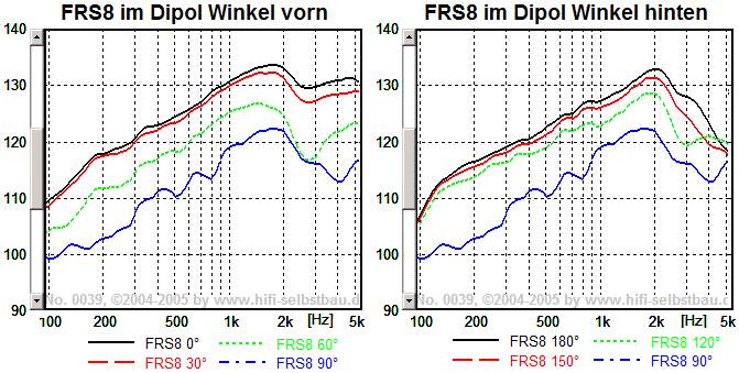

I turned the already completed baffle 180° and mounted the driver to the flat side, with the taper acting as a kind of waveguide:
This led to a much better response all around. You can see the effect of the waveguide in the beaming of the response to the front (Winkel vorn):

Rudolf, thank you very much for sharing your experience. I see that you're using a small-diameter loudspeaker in a thick baffle, which makes the positive effect of flaring the hole very prominent.
But I did not quite understand what you did in case 3. Did you taper your "already completed" rectangular baffle? You wrote you turned it 180 degrees, but around what axis?
The addition of a taper made the response smoother because it significantly increased the range of paths from the back side of the driver to the microphone — as I think.
Anton
Sorry, I obviously didn't use the proper expressions. What I wanted to say was that I turned the (tapered) baffle 180° around the vertical axis to use the driver cutout, that I had already flared at the rear side, as a sort of waveguide in the front.

Now I hope I get your point:
Picture 1: Driver mounted from the flared end on the non-tapered baffle.
Picture 2: Driver mounted from the flat side on the non-tapered baffle.
Picture 3: Driver mounted from the flat side on the tapered baffle.
...Then your measurements show that it's better to mount the driver on the flat side of a flared cut-out.
