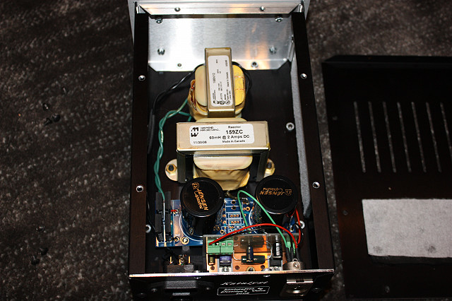

Ken & all,
Hi fellas,
In order to complement my Bolder SB3 w/Digital Enthusiast modifications, I built a power supply that puts out a fixed 5 volts.
Ingredients are as follows:
  • Furutech IEC
  • ACME fuse
  • Hammond split bobbin transformer (model 166N10) - this unit minimizes the need for an electrostatic shield
  • Hammond 60mH/2A choke (model 159ZC)
  • Peter Daniel PS board
  • MUR 3060 Hexfred Diodes (4)
  • Jensen 10,000 uf /63V DC Four Pole Capacitors (2)
  • Paul Hynes SR1MP shunt regulator
  • Neutrik XLR
  • VH Audio Copper wire
  • ERS sheets & Soundcoat damping
  • DIY Enclosures 0610 chassis
  • Engraving by Front Panel Express
Please feel free to ask any questions/comments/criticisms. I tried to implement a Felix AC filtration unit as well, but it didn't fit in the enclosure.
Anand.

Thanks for taking the time to show your project. Excellent build quality and your photos show how straight forward the internals of a power supply build can be.

Ken,
Excellent, I haven't changed it in 2 years. In fact, if I don't use the USB/HD option for the SB Touch, I should be able to use the same supply. I have Paul (Occam) Kaplan's 3A filtered power cord on it now since I couldn't fit a Felix. FWIW, this supply is now state of the art. An excellent power cord coupled with a wonderful in line filter then my Katalyst PS as listed above. Other than adding Bybees all over the place I can't think of anything else.
Trust me Ken, Paul Hynes supplies deliver. You should use them everywhere and I want to look into his current sources for my tube designs. My nearly finished Sabre 32 dac has his shunt regulators as well.

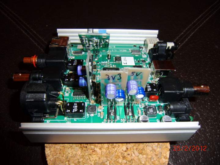

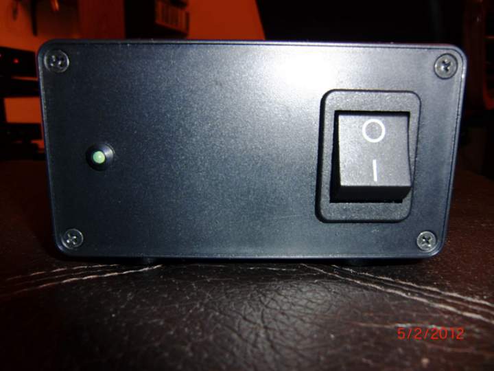

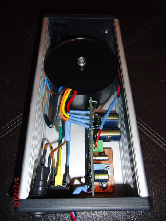

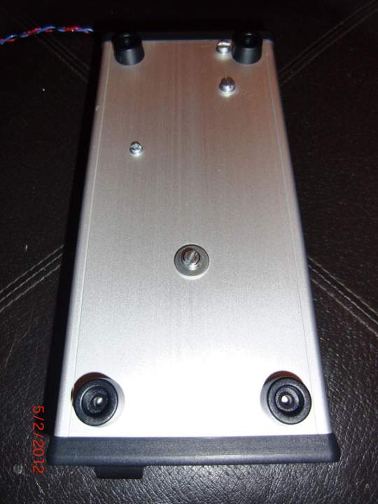

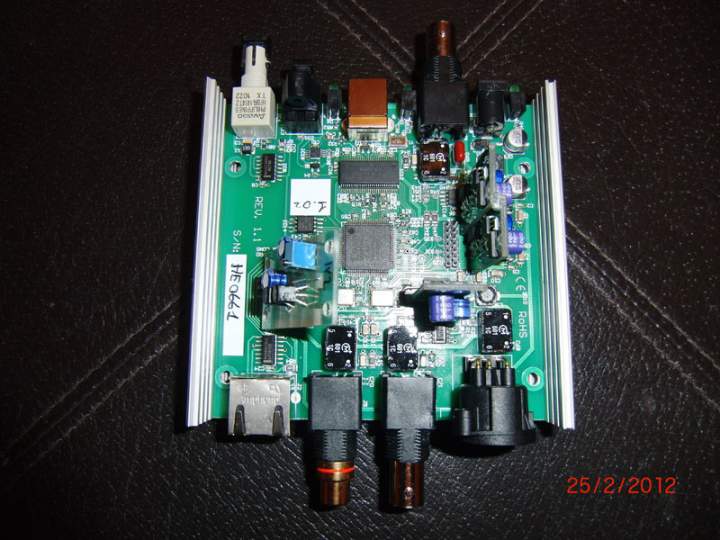

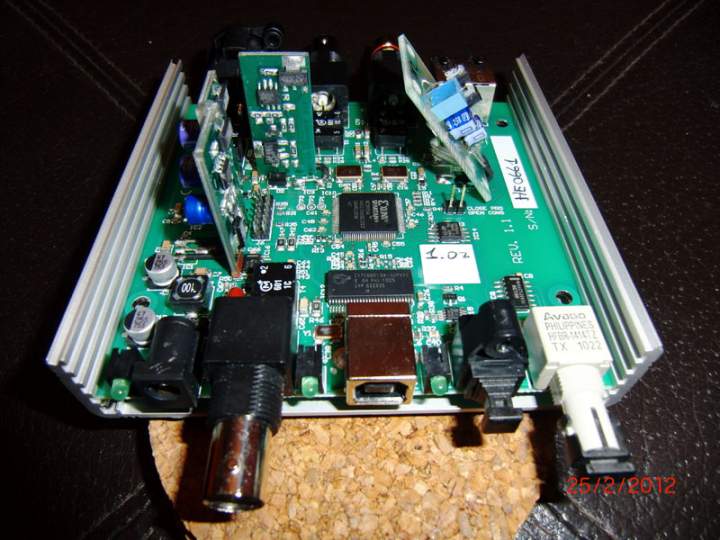

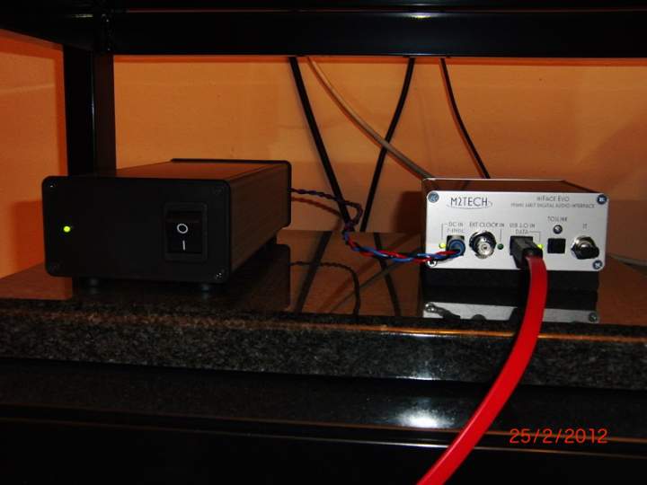

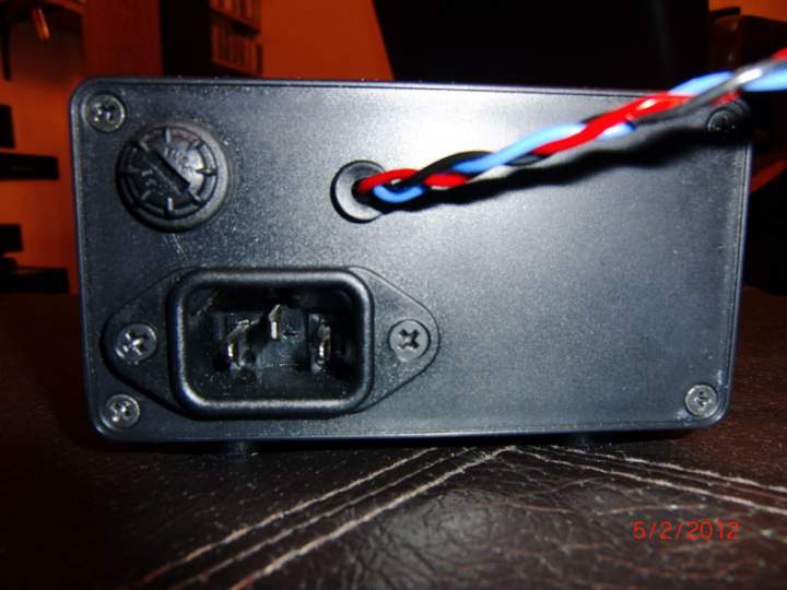

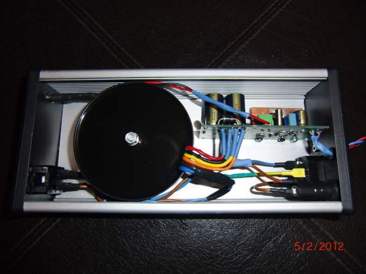

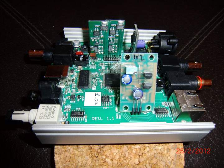

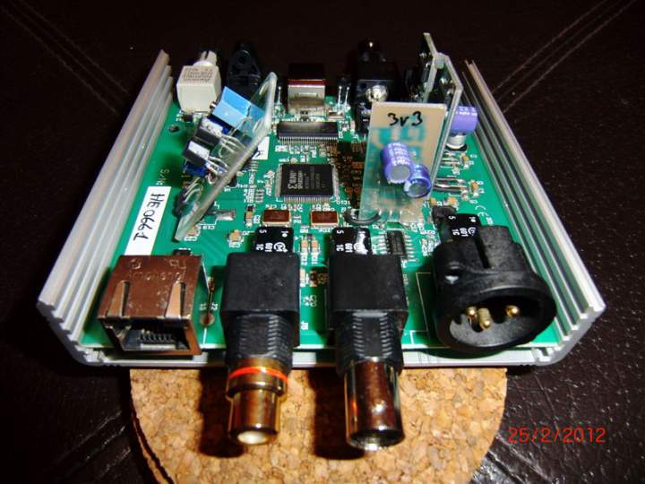

PR3-based PSU for M2Tech Evo:
Internal Evo upgrades:
Result:
Cheers Paul, many thanx!
