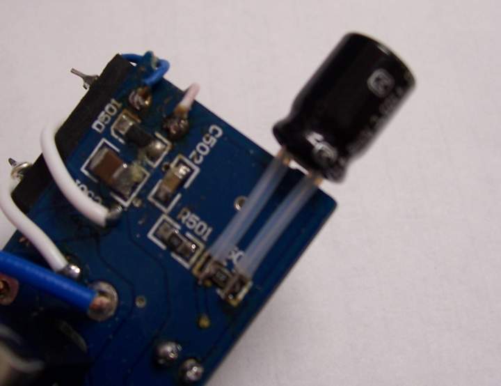

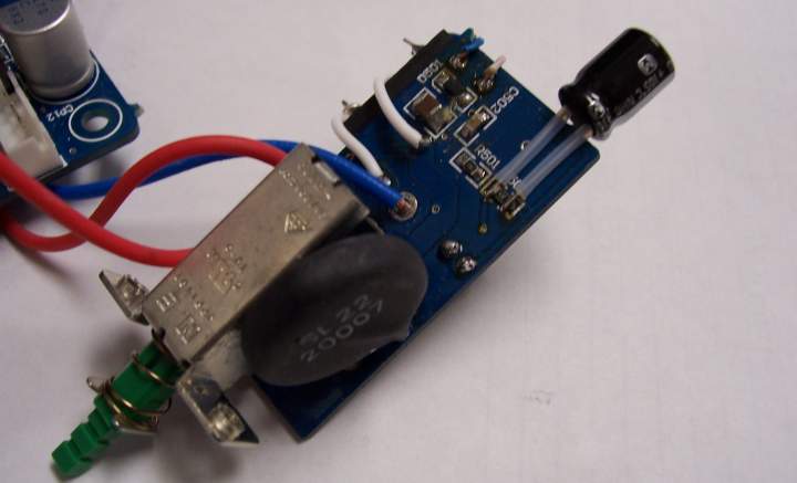

Guys, here is the fix for the internal ONE.2 soft-start which you can try yourselves with a low-current power supply.  We're going to send out caps but if you're anxious to get going, just go buy a 470 uF electrolytic cap and get on it!  We're using Digikey P5168-ND but Zman used Radio Shack and it worked fine.
Here is how to fix the ONE.2 internal soft-start.
Fix part: 470 uF electrolytic capacitor (any brand).  Stripe on side is negative leg.
FIX (1) - on the bottom of soft-start board, requires unscrewing power button
-- Connect across R502
-- Negative leg to the outside of the board
-- Note, don't short the cap on anything in side the unit - insulate with tape or whatever.
The fix extends the delay to around 1.5 seconds. Batteries can deliver 300A into the bulk cap.  With this soft-start, it's down to 300mA after 1 second.  That's 1,000 times less current.  Job done, thank you Aaron.
Please note that the polarity of the cap matters.  Be sure to put the negative stripe to the outside of the board as shown.
Here's Fix 1 which is easier to see but requires removing the soft-start board since R502 is on the underside.
Here's a close-up:
The fix requires simply melting the solder on the ends (called "tinning") and melting the tinned ends to the already tinned sides of R502.  This avoids your having to hold the board, solder, hot soldering iron, and cap all together at once.  Instead, you just put the board on the table, position the cap leads properly, and use the slight pressure of the hot iron to melt the already partially solder ends of the capacitors to the edges of R502.  Once the solder melts the two together, that's it.  Just make sure the stripe (short lead) is on the outside towards the edge of the board.  The plastic tubing you see in the photos - that's totally optional, a bit of clear tape over the leads when your finished would be fine just to prevent the leads from touching any other conductive part in the unit.
