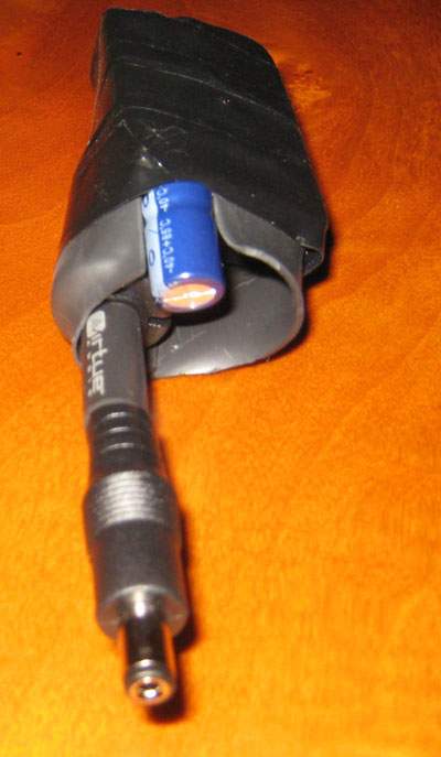

Added a 15A switch to the DC cricuit for a little extra safety while not in use, and to make it more user friendly with the TWO (so I don't have to power it on buy plugging in the connector). (And yes, I just taped the switch to the side of the battery! How embarassing - I really do need to find an enclosure..)
Also added the 470uf capacitor to the external soft start (though I'm still not sure if the soft-start actually does anything now that the internal switch is not in use..). Now to find an 8A slow blow fuse! (these are, for some reason, quite hard to find locally)

Sorry if there was any confusion: The soft-start is for my TWO classic, not the M901 pictured. I put a switch in the circuit mostly for compatability with the TWO as things currently stand.

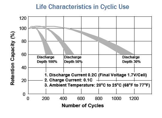

I don't have a lot of personal experience with lead acid batteries. However, I don't think Gary Dodd's observation of batteries lasting longer given deeper discharge patterns is a product of "memory effect". The term "memory effect" was introduced to describe how NiCd batteries (ie, those that powered cell and cordless phones prior to Lithium ion varieties) would rapidly loose capacity if only partialy discharged and then recharged to the same level. After only a few cycles of discharging and recharging to the same partial capacity, NiCd batteries would be often behave as if their full capacity was only that of the truncated capacity used in those few cycles. This surprisingly happened rarely in most applications as only those that required using identical truncated capacities (the same shortenned cycle) were prone to this memory effect. In reality "memory effects" experienced by the majority of people who used NiCd batteries with varied charge cycles was probably due to other contributing factors such as construction quality of the cells, number of total charge cycles, battery age, etc.
That is not to say that Gary Dodd was mistaken in his observations. It is very likely that fuller discharge patterns may ultimately provide a longer lasting battery for his application, though, after reading his comments on the link posted, I am a little surprised at how much of a difference he reports this makes. I guess we would need to know what he considers to be a battery that is no longer usable. If, after 3 or 4 months the batteries no longer are able to power the same load for the originial 12 hours, there may still be a lot of life in them, especially when always in parallel with a charger, eliminating the need for such a large capacity. I am willing to bet that my simple 2-battery set up, connected full time to the charger will last at least a couple of years before any noticeable issues occur. SLA batteries, as all battery chemistries, do lose capacity with age, and they will only work for a limitted number of cycles. However, the shallower the discharge cycle, the greater the total number of cycles (ie, if you fully discharge an SLA battery you may only see 400 or so cycles, but with shallow discharge cycles you may see 3 times this many or more in the battery's lifetime). Note the graph below, taken from a technical brochure.
Based on this, I would have thought that any real advantage of using deeper cycles over shallower cycles would be minimal. Gary seems to have observed otherwise... Perhaps this was brought on by using a combination of mostly shallow charge cycles with some deep cycles (as is known to kill automotive SLA batteries)? It would probably be best to get more information from Gary or someone who knows more about battery chemistry.
